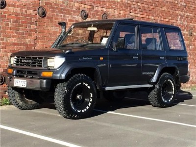

So I've been shopping for a manual KZJ78 with sunroof and difflocks for a while now and this came up. I've seen 4 so far and I missed 2 of them and couldn't afford one of them. KZJ78 manual with sunroof and difflocks are pretty rare.
http://www.trademe.co.nz/motors/used-cars/toyota/auction-761265820.htm
But the thing is this one's 250,000kms, not as tidy and a whopping 15k! I can afford it but I don't know if I want to spend that much. My original budget is around 12k for the truck and an extra 3k for intercooler add on.

What do you guys think? Worth the buy? Or should I just wait for a next cheaper and better one to come up? $15000, dealer's 90% sure head's been replaced recently, had big bore exhaust.
I won't be doing any hardcore offroading on this. It'll be a daily driver and family wagon for holiday camping trips. But the ultimate reason of purchase is personal preference. I just like the square shape of it lol.

Btw, I can see an OffRoadExpress sticker on there. If the previous owner can pm me that would be of most help as the dealer's not really answering my questions properly.

15k is too much I have seen manual ones go for about 9500 unmolested with a rear locker, 8-12 max, no mention of the head being done and its at 250k so factor in another 2500 to get this done
Check any along the roofline for rust and the sills and rear corners for rust/damage
ECU's are another known problem, $300 to repair
Also if it has a dual mass flywheel that's worn out .... 2k from memory
Check the power steering pump for leaks
Get the fuel pump checked
Check the viscous fan hub as well as the condition of the radiator fluid
Check the underside for damage

I havn't been watching prices but it looks dear to me. I've got kzj78, manual, factory diff. For comparison I paid $18, 6 years ago - incl 2 sets of wheels, near new road and mud tires, winch, cargo drawers, bars, prs radio, full height clip on caravan awning, snorkel, alarm, etc, etc 150K's, full service history, very very tidy (not any more).

If you look carefully at pic 11. The bolt at end of suspension arm doesn't look right .Its not centered, appears to be too high meaning bush might be slogged out.

Or it has castor correction bushes??

Shouldn't need any not like its got any real lift ... but could be.

All that guy does is buy cheap trucks on TM stick some black rims and MT's on then about 2 litres of silicone and asks thousands more than original price. Was a hilux on there a couple of months ago, original list price was $5k he did his tarting up and then tried to sell it for $12K
