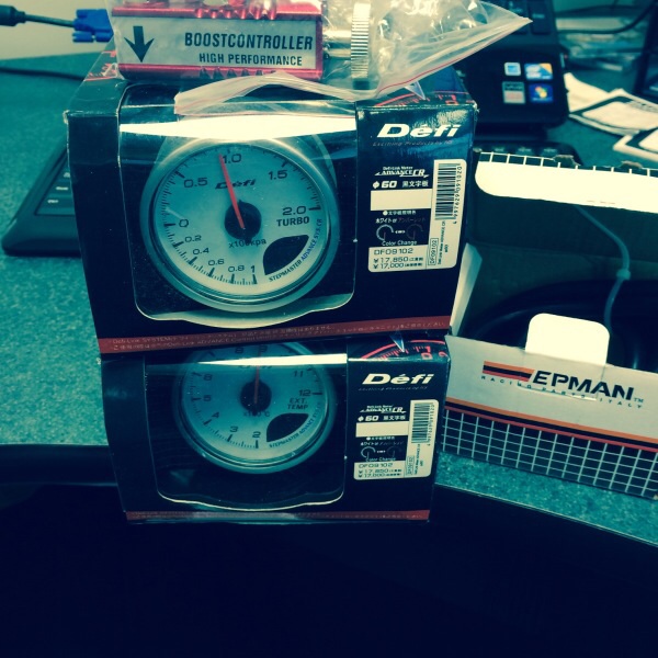

Hey ya,
Christmas arrived today. See below...
I'm installing these in the challenger 4m40.
So will post the process.
Boost gauge
EGT Gauge
Boost controll
I understand no point spacing the waste gate as boost controller does similar thing? Is that right?

would have been better if you bought diesel ones rather than petrol.
you will need to have the egt gauge as pre turbo sensor otherwise it will annoy you as it will do very little if its after turbo.

I'm installing in middle of exhaust manifold pre turbo so gauges are well suited.
I will install mine on Monday and you can decide if you like the look. I specifically bought this model for its light colours and the warning alarm that's adjustable to set.

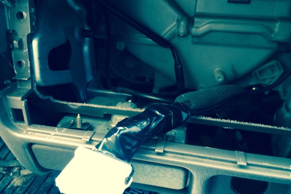

Update...
Wired gauges in and set in place on the steering column surrounds.
Fed wires through firewall and next is pluming in the boost line and egt probe
Had to settle with gauges here as on dash was to obvious. They sit well here and are not in the way of any dash lights. Now to install egt prob and connect I boost lines
All wires spliced in to correct wires...

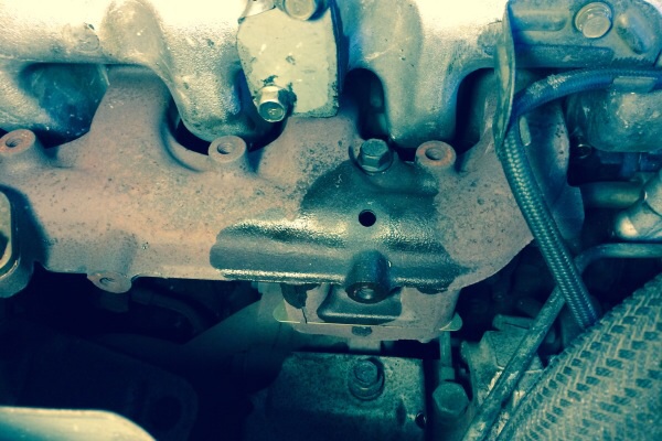

Pyrometers installed
Hole drilled then tapped in exhaust manifold
