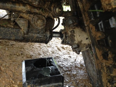

Nissan Safari LWB shortened an VG30DETT fitted.

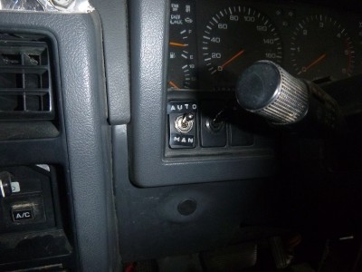

Been doing lots of think as to what effects it would have with all the solenoids in the nissan auto if you manualize it an unable to control things like the line pressure solenoid as it set up on a duty cycle for the auto ecu an overun solenoid for engine braking.
so thought bugger it, whats the worse can happen, i have a spare one or too.
so with lots of drawings an scribbles looking at ways i can wire it in to existing loom an with a flick of the switch i can choose either auto for town or manual for hills an events.
Yes there was a note pad beside bed for those night ya wake up thinking that might work.(must note that down)
After all this i wire it up to the wiring diag i drew(pritty much the same as the toyota ones with a couple of extra diodes for ecu to prevent back feed.) last night test drove. it works awesome.
flick the switch on the run an your in either manual or auto. good for the hills.

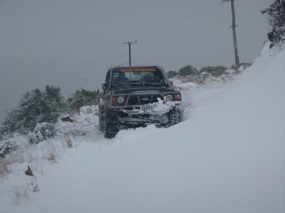

Though I better blow the dust off thread and update it a bit.

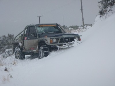

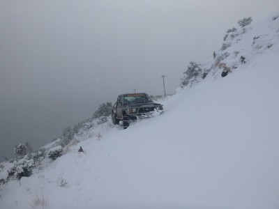

Here's some pictures of the truck in the snow, wish I had 4 chains rather than 2. back keeps sliding were ever it like. become a little scary that close to the edge. and my friends behind me couldn't get to were I was so decided to head back to a safer altitude. truck and all electrics still worked fine with no issues in this cold environment.

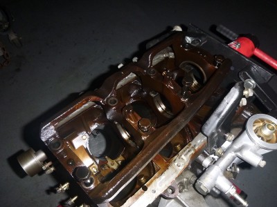

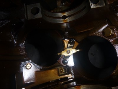

Was time to sort out a couple of issues I found the vg motors have and refresh engine. seems to be lots of good info out there on the net.
So I picked up a spare motor, ripped it to bits an went through it.

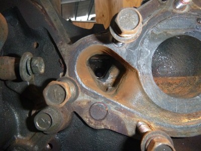

First was the water gallery's and the poor casting issue casing poor water flow to rear cyl's.Even more so in the 4x4 environment we play in. The loads seem to be much greater.
Next was the soft valves some motors had, so in went a new set.
Then just a good clean down an look over how strong Nissan made the bottom ends with one solid bearing cap assembly webbed together and oil squirter's for the piston cooling and hi flow oil pump.
I also played with some different exhaust ideas but space was limiting.
they say splitting the pipes helps prevent pulsing an turbulence on turbo spal up wen off /on throttle etc, worth a try I thought.Also time to fit pyros in with there.

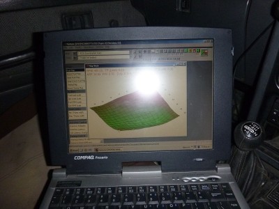

While engine is now in and changed injectors again to one's we can control an tune more easier rather than to big an flooding it but still larger than factory.
I down loaded software so that me an my friend's can tune it our selves,
So I put lots of gauges in so as to be able to monitor what the ecu cant. which helps heaps.
My friend's are far more up to speed with this ecu tuning so my main part was to fuel it up an let them bugger off an tune (also play)it for a few hours at I time. wen they come back there faces said motor than words.(They do say each time we would like to do some more tuning, as its fun an the maps are getting betting an need fine tuning).very noticeable driving it after they do there magic.

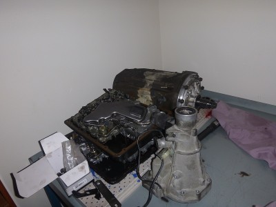

Was time for a replacement trans to be built out of 300zx an safari auto.
Also a 2nd trans cooler fitted in to bonnet scoop to help control the temps. The 2nd cooler in the bonnet removed around 30degC off the temps all round so was happy with the effort.
Time will tell. this weekend i'll be towing a tandem trailer all the way to Queenstown and back with this truck, aprox 10hrs one way.
