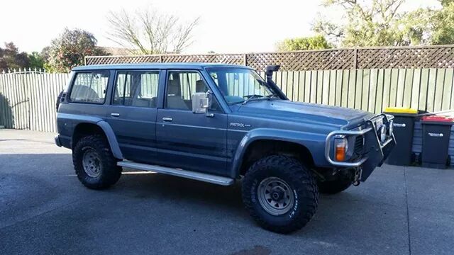

Well,
Thought I would start a build thread as I will likely be needing plenty of guidence along the way!
Started off with a bone stock 1990 nissan patrol. Its an aussie import powered by a carberated rb30 engine. I made the call for petrol due to the minimal usage and didnt plan on the build getting as in depth as im now looking (how all good projects start)
So my initial plans wee;
*33" mud tyres
*bull bar
*small lift
*winch
I made a trip to the west coast with all but the winch, and quickly decided I need MORE! (Pics to come soon)
So first issue I found. Being carbie they dont like steep hills...... stall and make it a mission to get back on flat ground to start (2 hours hand winching a dead truck up a steep ass hill will teach ya quick)
So now I am planning to get EFI running gear from an old vl commodore or R31 skyline that are RB30 injected SOHC engines.
From there, my list has grown to consist of;
*12000 lb winch
*auto locker front and rear
*2" body lift
*long travel shocks (already have 2" suspension lift)
*possibly look at space to run 35" tyres when my new 33"s need replacing
Rock sliders and wrap around bars
Peoples thoughts?am I going in the right direction?
