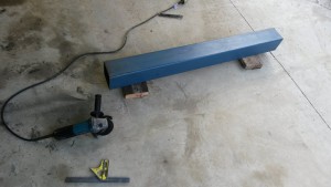

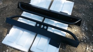

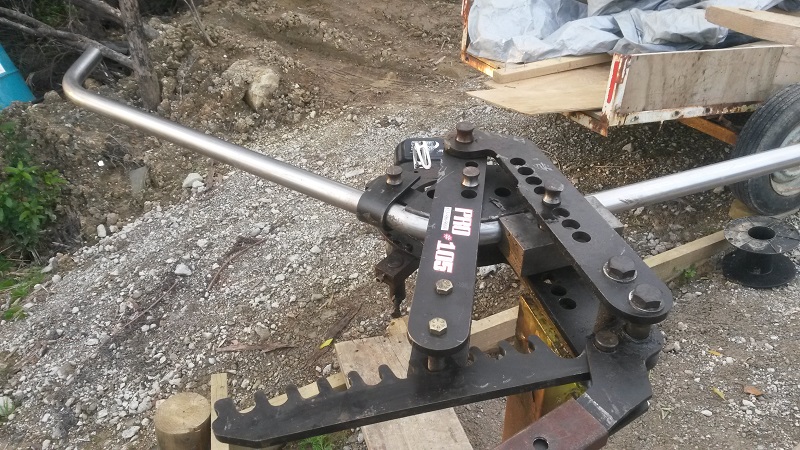

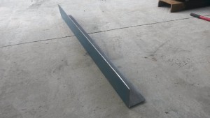

Next on my list is rock sliders. Found some cool ones on Low Range Off Road so got to copying :D
Mattrade
Posts: 386
Re: Suzuki sj413
Post by Mattrade »
Its a body mount style held on with riv nuts and bolts through the floor with sandwich plates for strength.
Likes the design because it sits up real high and looks real tidy 8)
Mattrade
Posts: 386
Re: Suzuki sj413
Post by Mattrade »

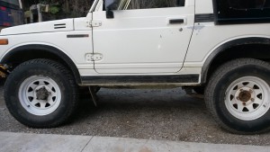

Got a bit more done. Next is to tie the middle of the tube back.

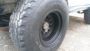

Also got some huge off set alloy 15 X 10 with 31. Can't turn at the moment but looks wicked ha ha

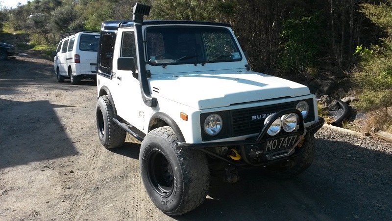

All Finished :D

Mattrade wrote:All Finished :D
Very nice!

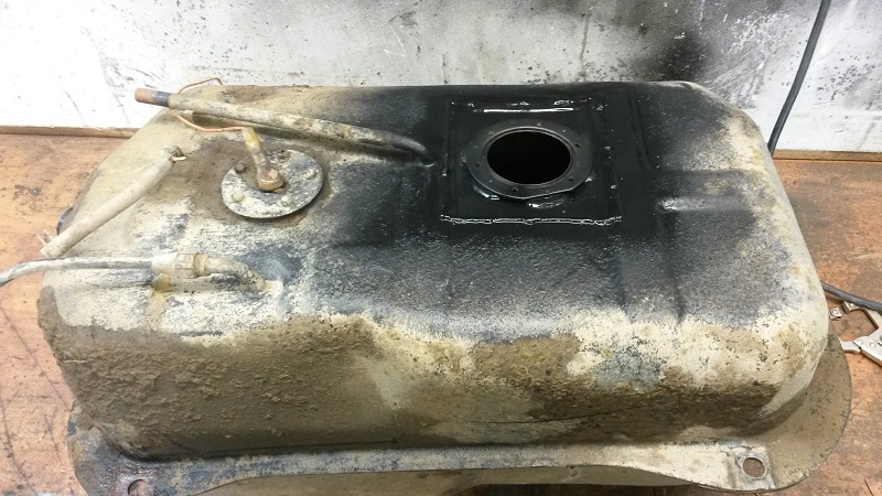

Using escudo stock in tank pump but cutting out and welding in sj one.

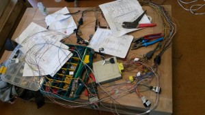

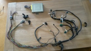

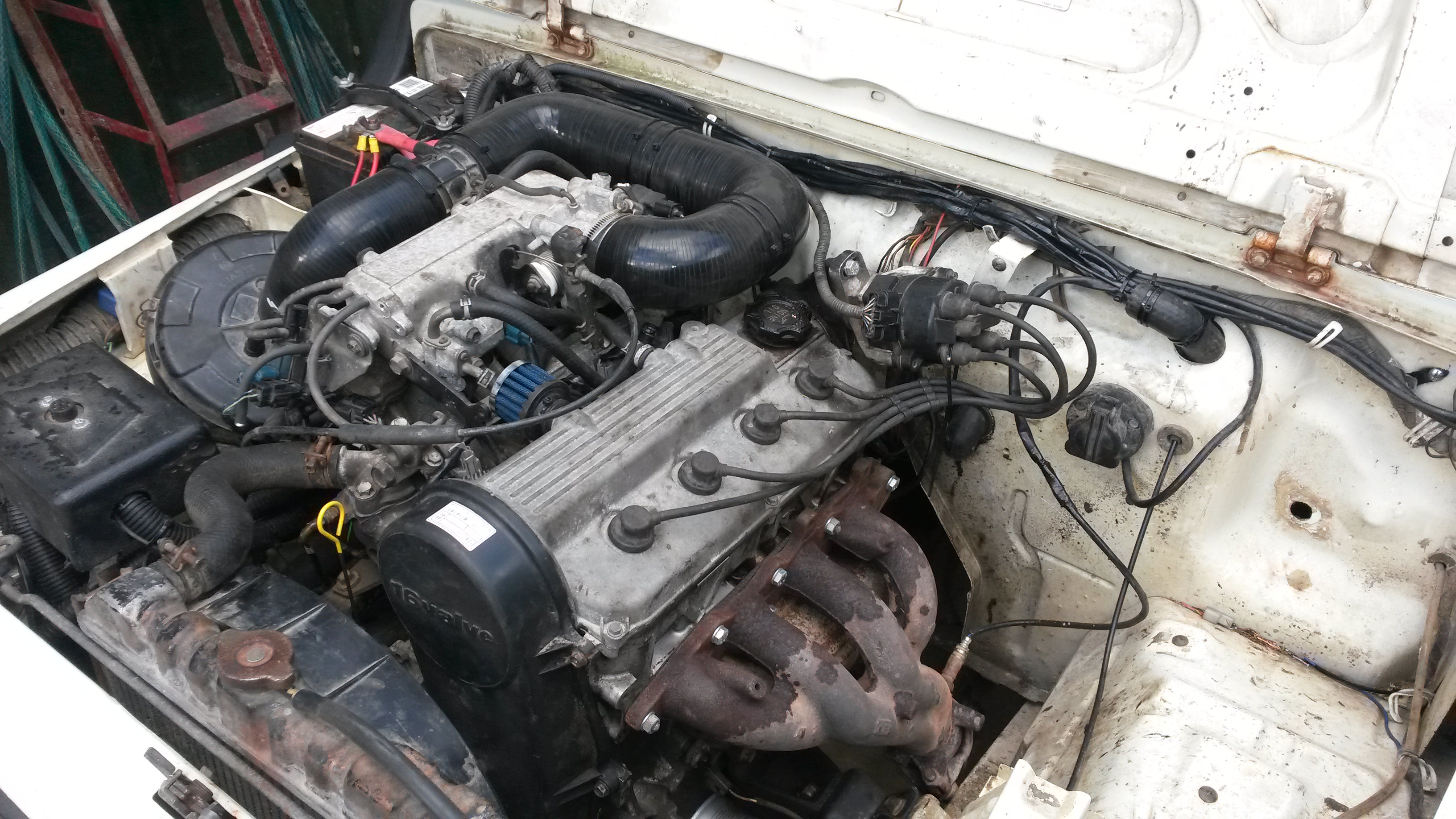

Downloaded a ecu pin out and got to wiring up the engine. Also got the Vitara fuel pump welded in.

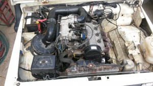

Made a bracket to hold ecu above the glove box. To try keep it as dry as possible. Had a problem getting her started but found I had missed 1 wire but after it was found she started right up :D
Next plumbed it up to original air box and snorkel.
Quick oil change and fresh spark plugs.
runs mint love the extra power and uses half the gas my old badly tuned engine used.

Looks just like its always been in there haha. The main snag I've hit is that the extractors don't quite clear the top suspension arm (3 link coil front). Going to mess with the drivers side engine mount think of I can lean it over a fraction more it will just clear. Its a good hand built stainless manifold that came with the engine so don't really want to take it off or hack it up if I can help it. Fixed the carb so ordered the parts from the UK to fine tune it for that engine, just gotta plumb in a pressure reg to stop it throwing fuel everywhere at idle haha. And numerous other things to finish, I swear the more I get done the more bits it ends up in haha

Nice work on the intake setup, definitely one of the best ones I've seen. Just wondering if you blocked off the breather hose connection on the airbox lid, obvious I know but sometimes these things can be overlooked. :wink:
Mattrade
Posts: 386
Re: Suzuki sj413
Post by Mattrade »
ha ha thanks. Ya shoved a bolt in the hole, but been thinking the breather filter on the rocker cover may let water in so thinking of plumbing it back to the air box.
