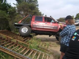

Got it pretty much finished now. Still a few bits and pieces to tidy up but got it up the bank for a flex up. Could of got a bit more out of it but the tray sits on the tyres so might need to mod it a bit.

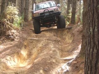

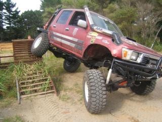

Went for first run on suspension just a few pics.. Really impressed with it
Still hitting tray
Still hitting tray
