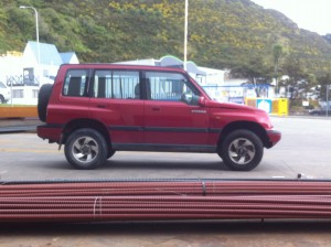

Finally sorted. Found some v6 fronts and some toughdog lifted jimny springs.
Has lifted pretty much 2 inch at both ends. Pretty happy how it sits now with carrying capacity still being a shade high at the back
Plenty of droop still with e30 bimmer shocks
