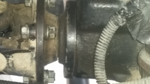

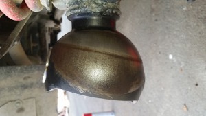

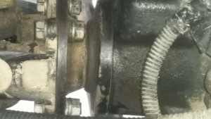

I was underneath greasing my drive shafts and noticed the front diff pinion seal leaking a weee bit. Jacked it up and removed the wheels. Gave the hubs a wee turn by hand and watched the drive shaft flange move about 5mm back and forth when turning the hubs forward just a tad, then backwards a tad. Im just wondering if this is normal amount of movement or not??? The pictures are taken showing the amount it moves.

There should be no movement in the pinion what so ever, needs to be tight or really bad things happen as is any up or down movement.
After reading your description again, when turning back and forward there is some slack in the gears from going forward to backwards, there is prob 5 mm or so in my truck but cant say whats normal i know there should be some at least.
If your talking about the dust seal how ever they can get bent by rocks etc and make things look out of shape/alignment (the black painted bit with chips of paint off it)

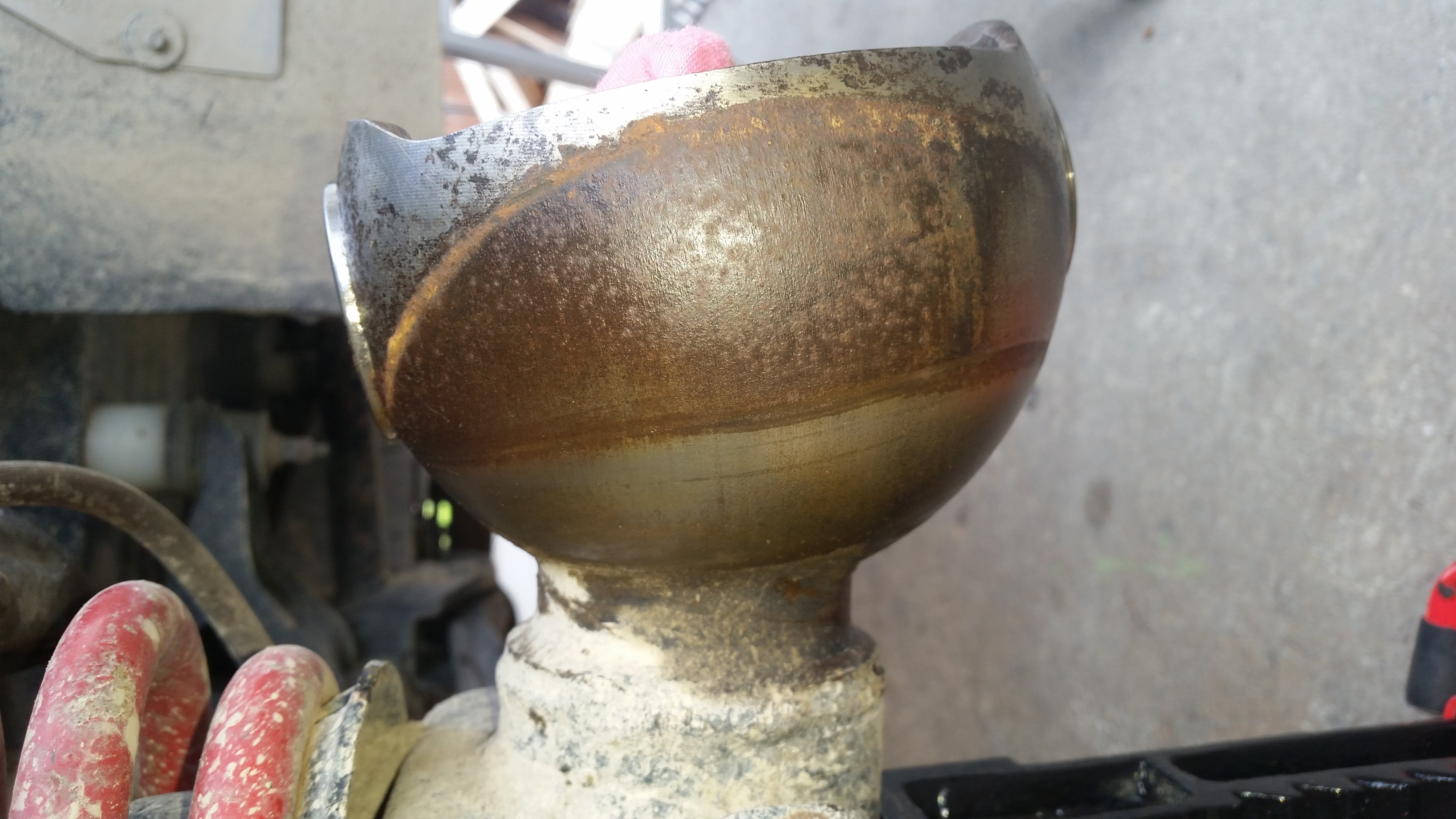

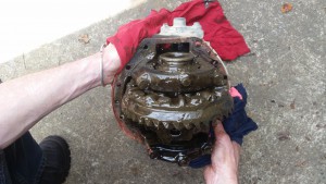

Well Ive got it all out and totally stripped, well the diff housing is. Going to work out cost to have the diff rebuild and getting the housing knuckles repaired, as they are were worn. Looks like they are the cause or the start of the problems and if I dont fix them or get a second hand one. This will keep on happening.
Pictures......
