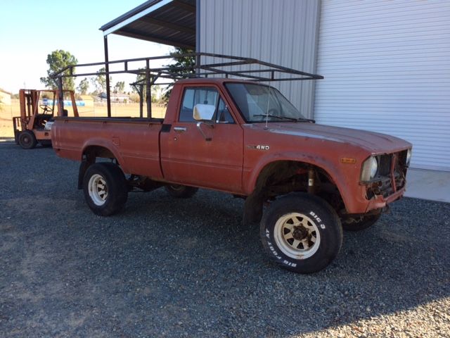

I picked up this 1980 long bed from its original owner last week. I wasnt really looking for a project but I couldnt pass it up. Its going to get lots of tube work and links. I have not decided on axles engine or anything else yet.

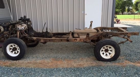

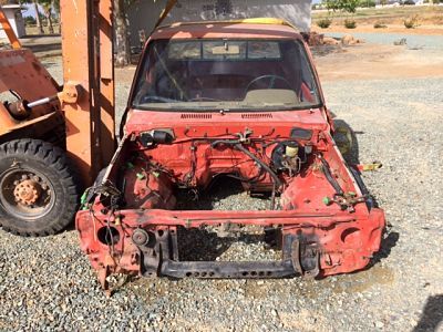

Got a little more done today. The floor was rusted out so just removed it all. Its now sitting on the chassis table. Im going to build a 2" round tube sub frame and the rest of the tube work will be 1.75". Links front and rear with rear trailing arms. At the chassis end of the trailing arms I will machine Delrin bushings to press into the bushing sleeve and all other chassis and axle ends will be 1.25" heims.

The 2" DOM sub frame is all done and attached to the cab. I welded fish plates to the inside of the cab for the tube to tie into.
