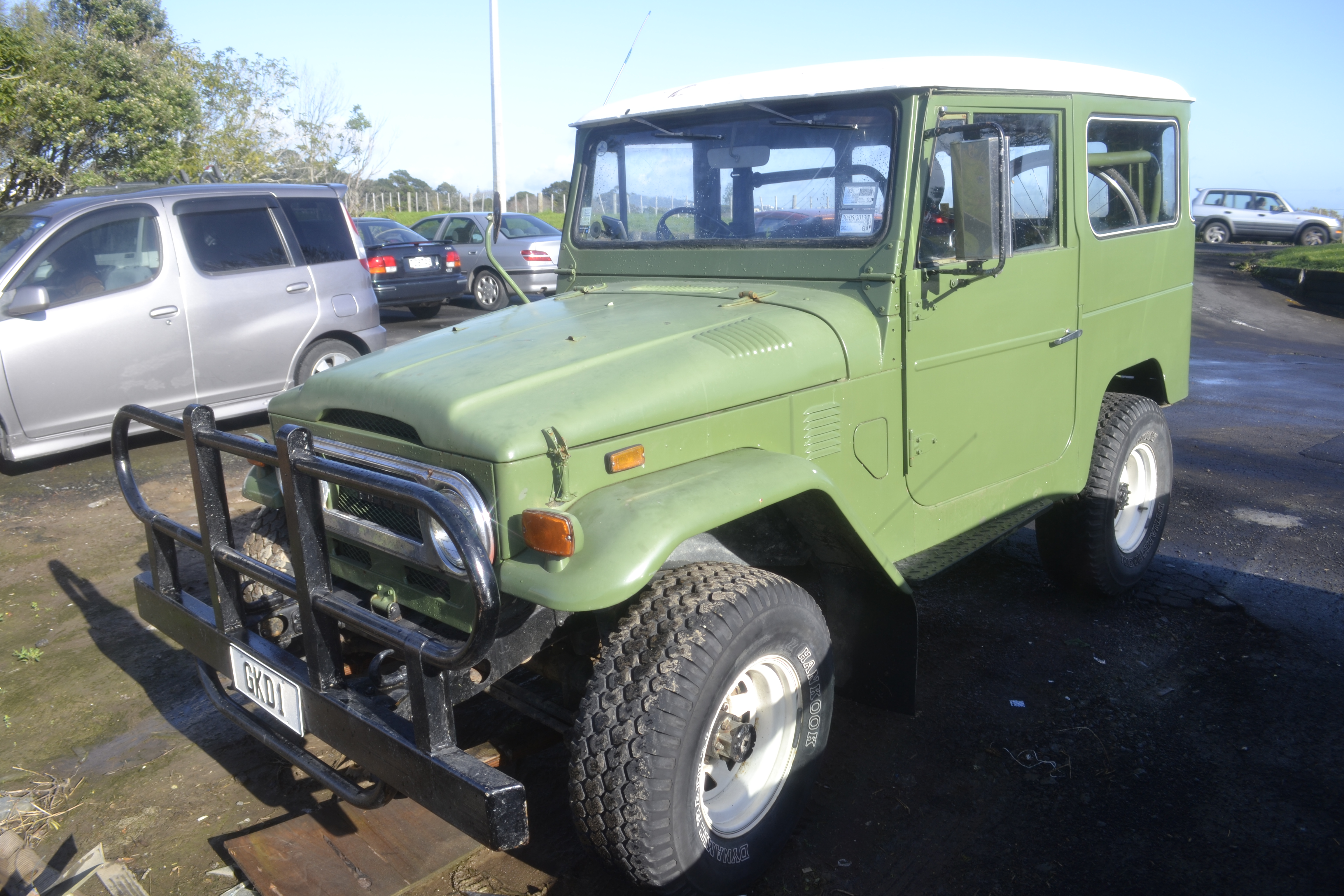

Sadly this beautful BJ40 may have to hit the hay..
A bearing broke and the crank soon followed whilst on the motorway heading for a long overdue offroad trip south to the Hawkes Bay.. The second trip since owning it.
It was found in a shed a few years back in the Waikato, I brought it to Auckland where I had a fair amount of work done.
It's an awesome car, it would be a shame to break into parts for sale as everything but the engine is good.
I have been quoted 6K full engine rebuild for the 3B 3.4 litre diesel engine...
i'm not sure I can put this kind of money into this luxury that i'm quite attached to!
Can anyone advise what to do with it?! Anyone have a spare 3B engine?!
I may bite the bullet or put into storage for another year, as the missus would like us to save for a house (same old story).
Any information would be appreciated! Thanks
