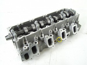

Imsohi, you are referring to this bung right?
Bung
Bung

Here's a pic of the bung. Sorry bad photo used my phone.
