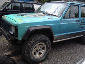

cheap lift for your xj,holesaw some rings out of hard plastic, i used some from work that was 13mm thick,extend factory shackles 60mm, boom 60mm lift for free,use the rings youve cut to space front coils.
cold dry air,seal all holes on airbox, holesaw hole in back to suit what pipe youve got, cut hole by wiper motor, i used ithink a commodore airbox flexy,i used some wurth urathane to seal everthing up, the flexy allows it to be removable.
xj gets hot?,i made a reverse facing scoop and then fitted a a/c fan under the scoop,ac fan pushes instead of pulling air,i have the bonnet fan switched with the eletric radiator fan, no more overheating
i also cut my tailgate as the factory one sucked,also made a good spot to pour drinks .
