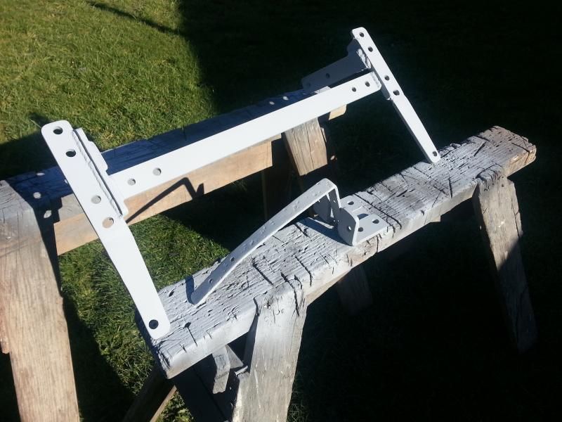

Clubs will not accept an unrated hook or bolts that dont meet the spec (neither will i for that matter i wont snatch anyone with substandard gear). Since it has no markings you cant be sure what it is.
Rated hooks are pretty cheap so i would go buy some more, i would also suggest making use of at least the 3 bolts that the hilux has on each side of the chassis. There has been times where the hook and abit of the chassis has been ripped out under snatching and that creates a dangerous missile.
This involves making a bit of bar that bolts to the three and then you bolt the hook to the bar, it also gives you hooks that are up the right way. Have a look at the below pic, this is mine its a bit more complex as braces both sides with a cross brace as well. Im talking about the bits on either side.
If you want to come have a look at mine for ideas your more than welcome to.

I have pretty much the same bracket on the front of my Surf, just a bit simpler, pick up on as many mounts as possible and gets your hooks up the right way too which is a bonus
