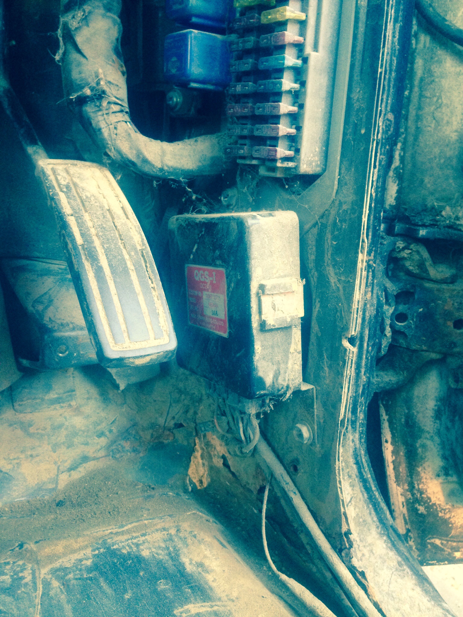

Removed my carpet noticed this elec box labelled qgs-I
Does anyone know what it does?
88 gq td42 swb
What's the QGS-I box below fuse box drivers side?

Re: What's the QGS-I box below fuse box drivers side?
Glow plug control relay
