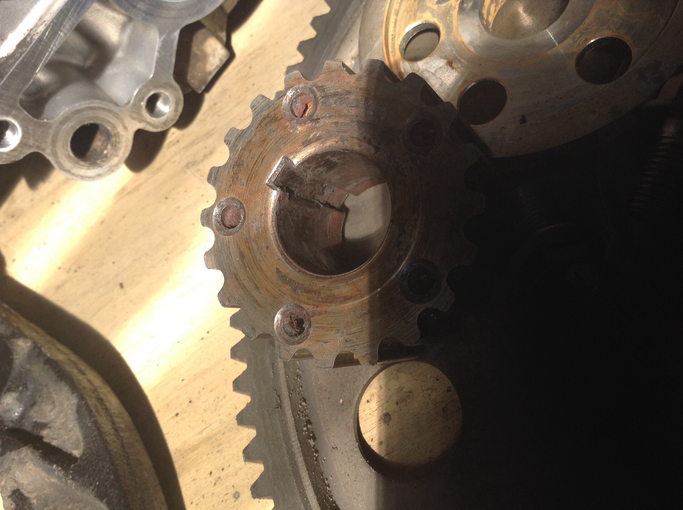

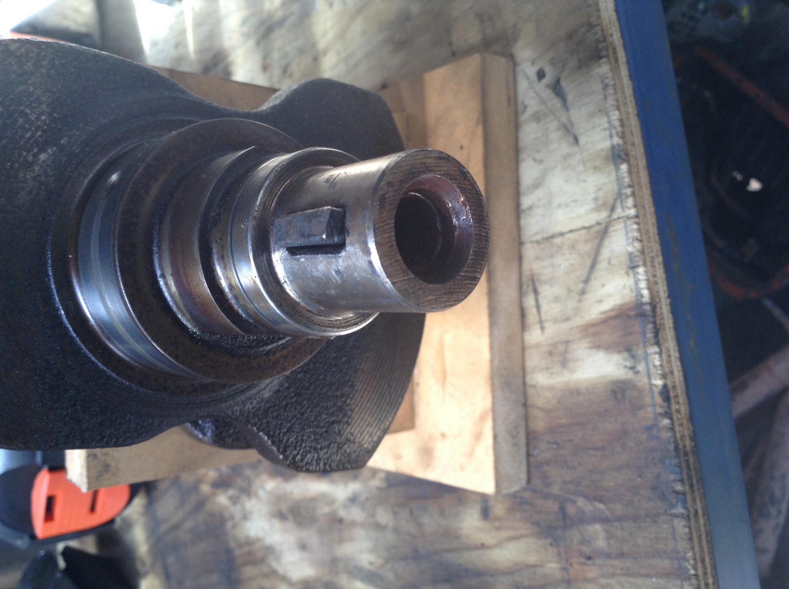

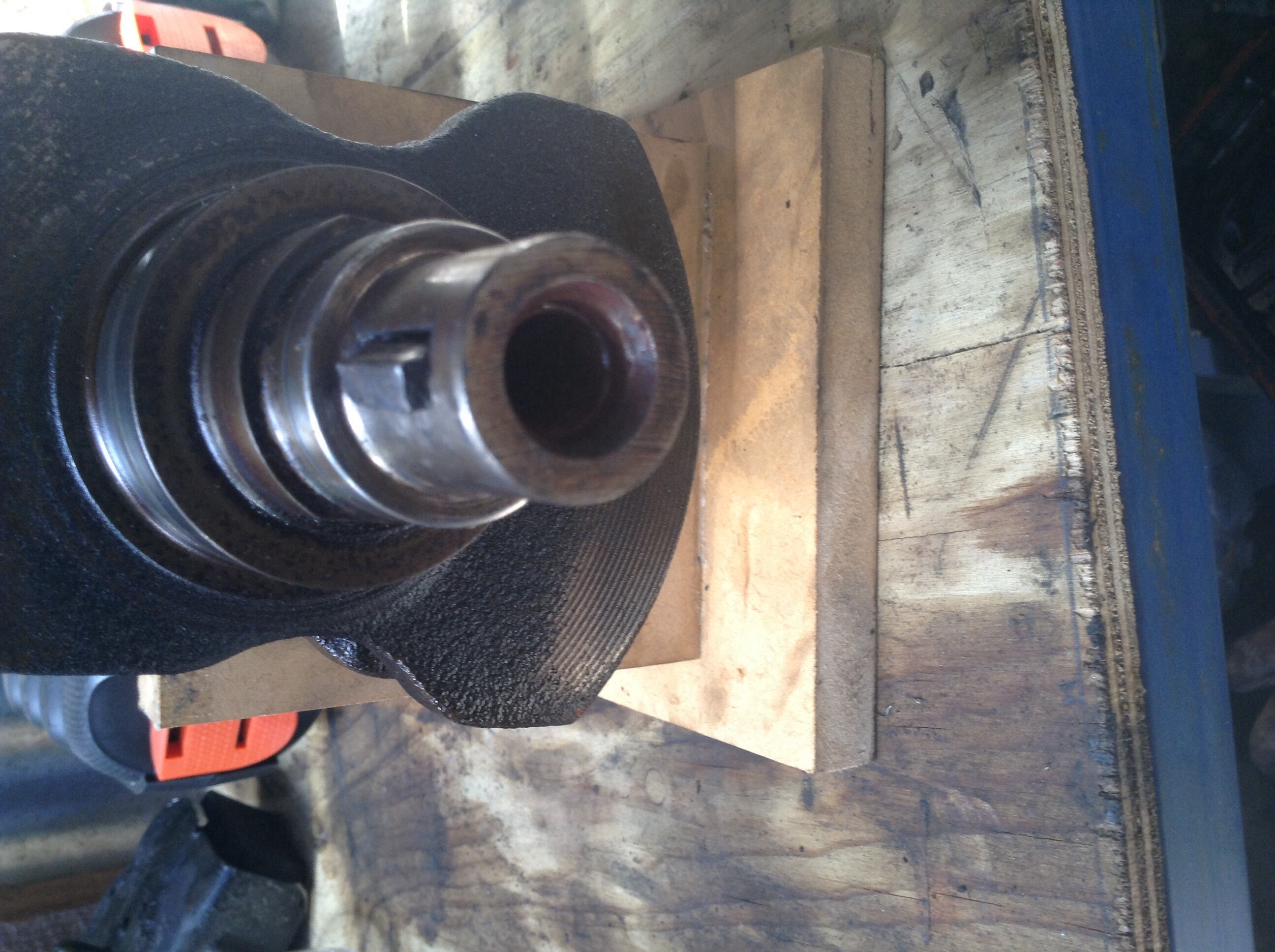

The only common problem that I can think of is the crank pulley bolt comes loose and allows the timing belt gear on the crank to move and slog out the key way, mine did this but there wasn't a noise just shit timing. Wouldn't hurt to check it.

Re: new here escudo question
pulled the vavle cover to check valves and everything in there couldn't find anything wrong in there so i pulled the sump off couldn't see anything wrong with the bearings or rods ,but then im not an engine builder so its off to someone more qualified to check it out and maybe rebuild it if its worth the cost.
