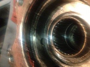

Need to get this bearing out.

Not 100% but I think the outer edge of that bearing should be flush with the edge the diff.
Can you tap the bearing back in?
Yes, I had a zoom in and there is space for the bearing to push in, best to get a socket that fits the diameter of the bearing and use it as a drift to tap the bearing in.

Sweet will try that after work. Wasnt sure if it is supposed to go in, or come out.

that bearing doesn't need to come out. its not stopping the head from coming out.

Diff is back in surf now havent tested it though. Cheers for the link but doing it the way they show would of damaged the bearing. In this case it cant of been driven home properly and was stopping the head coming out of the housing.
