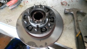

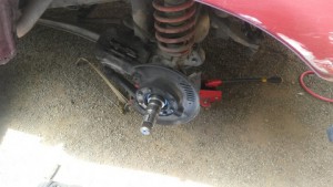

Anyhow back home and into the front axel luckly these had all the wheel nuts attached, jacked up to check play, yep to much there, remove the front wheel, caliper, finger tight nuts and the hub
into the garage to remove bearings clean and regrease with high temp wheel bearing grease
reassemble on truck and then onto the other side, bugger the back bearing stayed with the spindle out with the pullers to remove. A full grease of all steering joints and drive shafts was also done. As im doing the 2wd conversion shortly is was decided to put the free wheeling hubs on now (had to dig them out form the bottom of my hilux box and rebuild one of them but all assembled and good to go.
Drive flanges still in good condition will be put back into the hilux box as spares.
