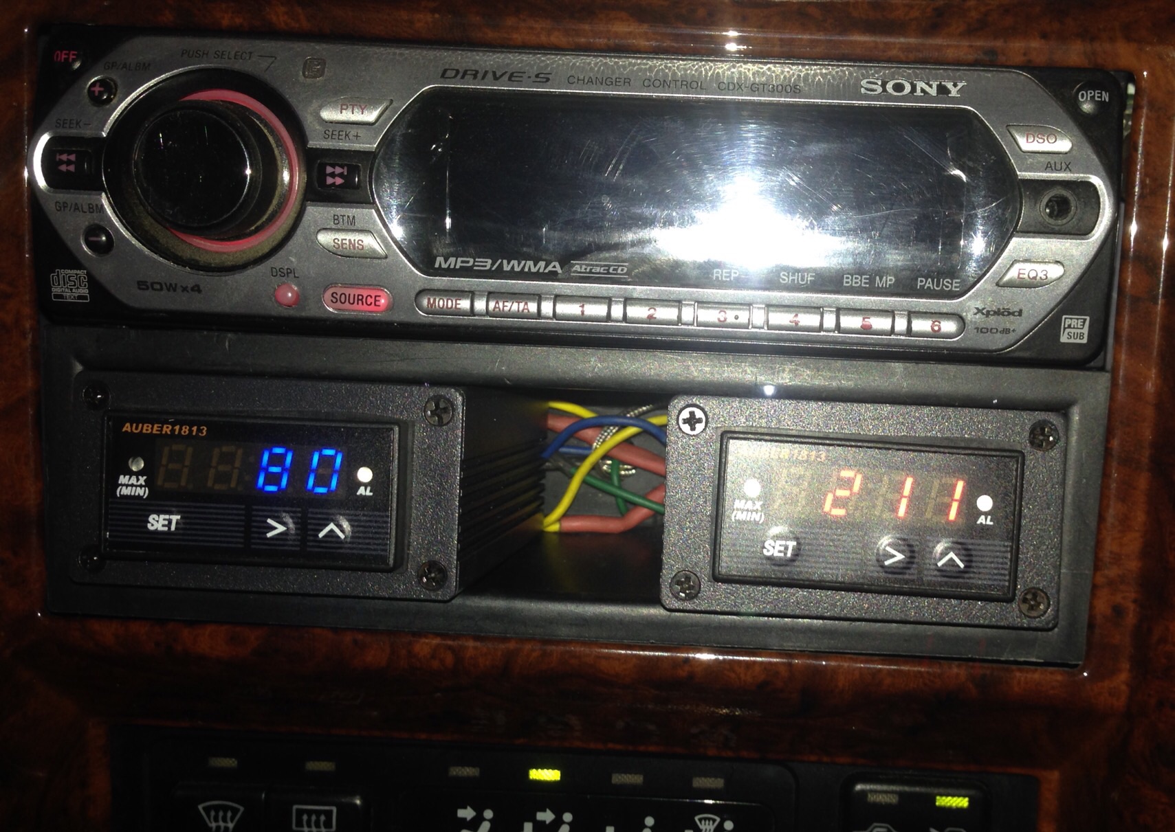

We installed the gauges into the trinket tray under the stereo. I ordered the enclosure boxes from auberins and they fit real nicely in the trinket tray held in with a piece of double sided tape.
The wiring in was pretty straight forward following the instructions: power,ground,sensor, and a feed from the headlamps which makes the gauges dim when you turn the lights on.
The only bit where we struggled was when we fired them up they were reading crazy numbers. Like 33 Celsius water whilst hot. We scratched our heads a bit until we realised that you needed to program the gauges so they matched the sensor type! Once we worked this out using the "Input Type" setting in the menu we were fine.
Here are some pics...
