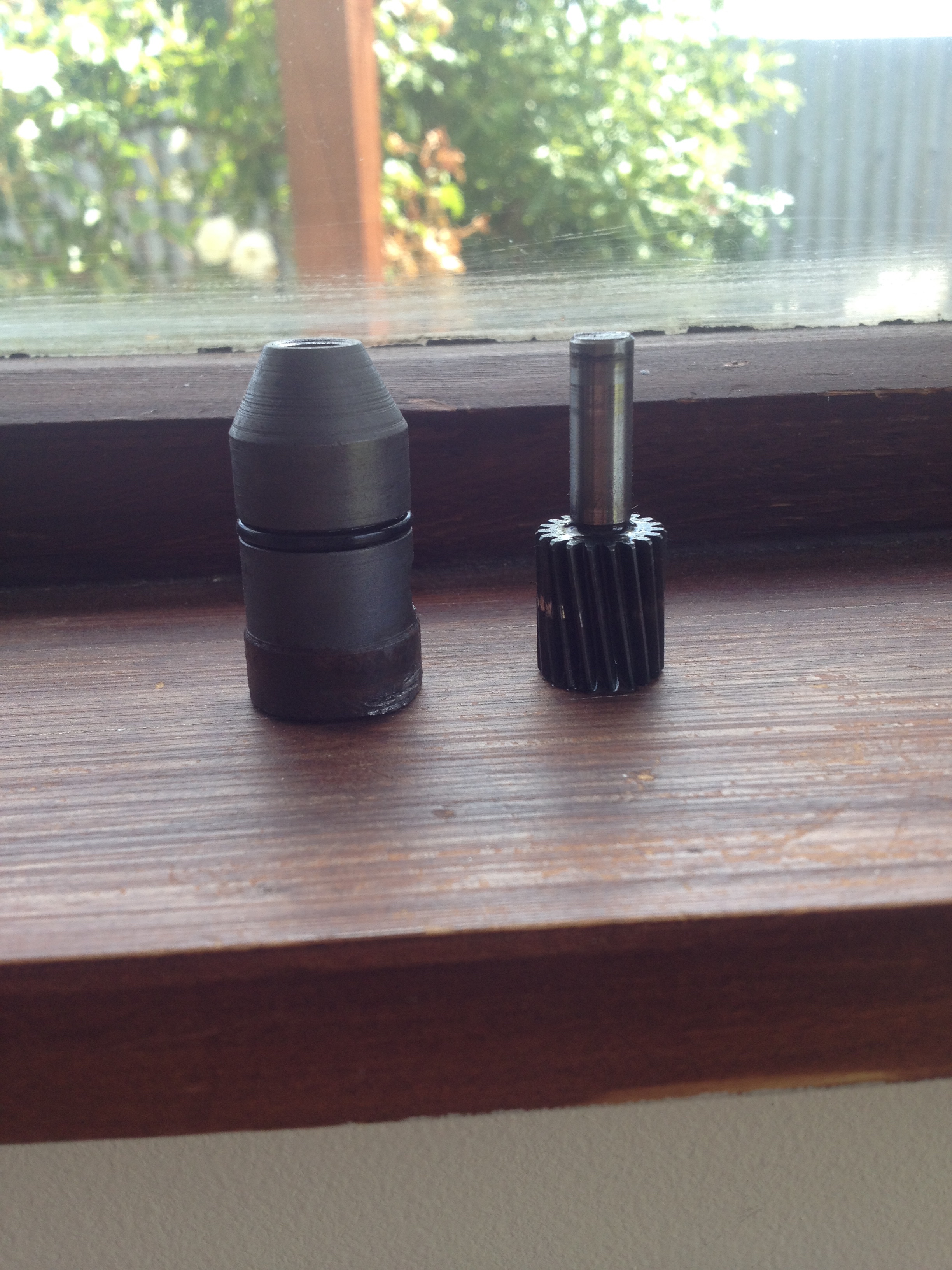

I've currently got the transfer box out trying to replace the speedo gear which is proving to be an absolute shocker of a job. I've tried drilling a bolt and putting a dowel through, grabbing the bolt with vice grips and hitting them with a hammer. So far I've only got as far as smashing one of my fingernails off. Any tips?

You're on the right track. Can just take a bit of a hit to get it out. I'd be careful not to score the housing with your pin though as it could damage the new seal when installing.

Success!!
Cheers for the tip mate worked a dream.
