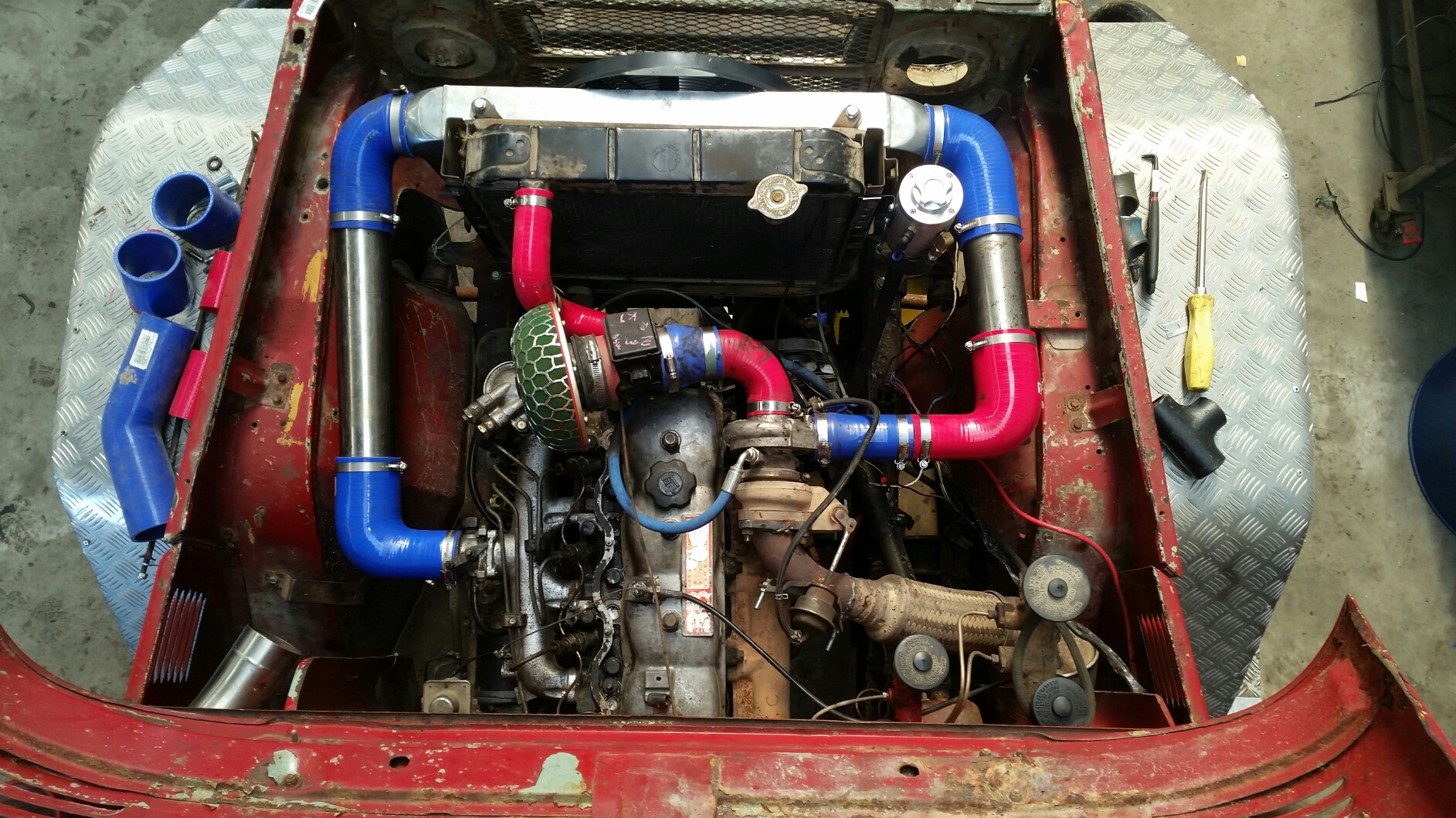

just fitted a 3b and turboed it and added a front mount intercooler. One turbo just won't do it so there will be another one added soon, just for the crack!
Big
Posts: 2134
Location: central Otago
Re: FJ40 "just for bashing"
Post by Big »
I wouldn't be doing that :shock: .. the 3b doesn't have the oil sprayers that cool the pistons like the 13bt does.. and all you'll do is fk it :cry: .. keep it low psi don't ask for much and it'll go all day everyday.. otherwise get another engine ready.. :lol:
diogenese
Posts: 307
Location: Temuka
Post by diogenese »
I'm fairly sure it does have the sprayers, it's a late Daihatsu built one. Anyway,if it does die then I'll just have to build it stronger next time :)
The turbo is a tiny thing off a 4d56 and is pretty much spooled up at idle, waste gate is set at 10 psi.
I'm going to run a pair of them in parallel one off 1 and 3 and the other off 2 and 4 to get even pulses and short small pipework to keep the gas speed up.
The ONLY reason for two is because someone said I couldn't do it :D

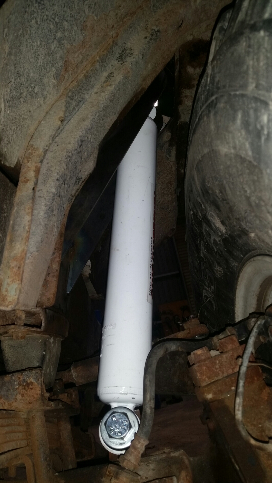

New shocks going in, thanks to Tom's offroad. They are rear GQ +6 inches!
