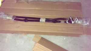

Currie Enterprises set up is not compatible with RHDs. Just ordeted a Crown HD kit. Hopefully it will be delivered in a week or so. Uses all factory mounts and threads, no modifications. Supposed to be solid tie rod (ZJ style) rather than hollow tube like TJ factory style. I'll post photos to compare when it gets here.
TJ
Posts: 2060
Location: in a Jeep
Re: TJ Build
Post by TJ »
It got delivered late yesterday. Looks heavier material. I'll do the fit in the next week or so:

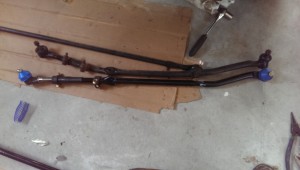

Unpacked them today
I think old ones are definitely bent slightly.....

All done, new drag link, tie rod and steering damper. Fit like a glove, no modifications required.
The unit I got was Crown Automotive HDSTRGCR3 Heavy Duty Steering Kit (Right Hand Drive) from Quadratec.com
