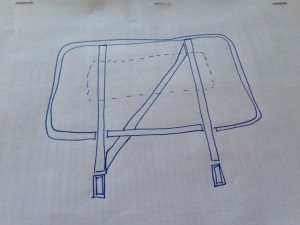

what about two uprights welded to the chassis basiccaly going past the window frame edge then a top horizontal piece shaped to match the outer shape of the cab and then returning down and back into the uprights, a diagonal brace from the l/h/s chassis to the top r/h/s upright head peice
a lot harder to discribe and no real way of drawing a picture on the pc
some times the advice from ya kids can be invaluable at times
i will try taking a photo of the drawing and posting it :oops:
this may actually work :D

But the more I think about it, if I did roll, the bottom "legs" of the hoop (where it mounts on the chassis) are too close together and would have little/no integrity. I guess a diagonal brace would help. Nice pic Mudlva, but I think you'rs has the same problem - the base is too narrow. Are hoops like this usually connected to the body/cab as well?

Def need a diagonal brace in there. Mine is mounted to chassis in similar shape to yours but with a A style brace (B pillar hoop). Can get a pic if you want.

Could use the same setup and add an A frame up from each chassis rail meeting in the center to stop it flexing sideways or crushing
