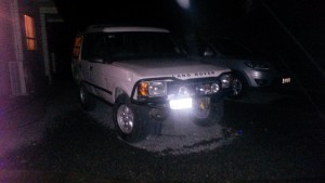

Nice. Post some pics. How is it power wise?
Re: axle swaps
Power is Good. I'm running a full front intercooler , straight through exhuast , boost at 18 psi and pump wound up. Exhuast Temps are all good. tows my 22 ft fishing boat fine and still gets bout 850 KS to a tank ( not towing tho ) .
