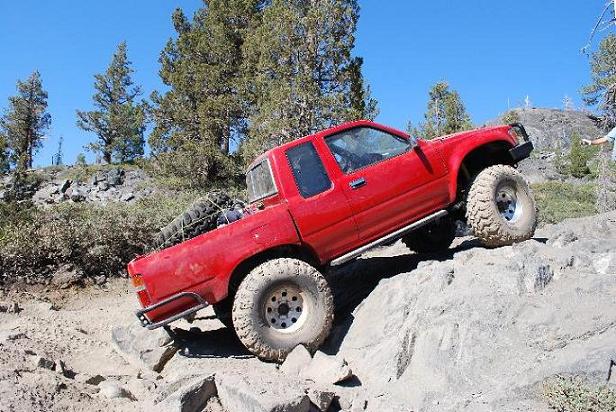

Hey guys,
I've done much searching (more so for photos) on these body swaps, but want to check that the extra cab will fit into the shorter wheelbase, coil rear, surf chassis. No doubt will have to move at least one pair of mounts but the front ones should all line up? And this should put the rear of the cab at about where the surfs rear wheel arch starts on the rear doors?
Thinking I'll either do this and build a flat deck… or buy a landcruiser :twisted:

Or do what i did and got cruiser chassie with hilux cab :roll:
Anyway yup will fit but she will be tight on room

Sounds like the goods but… Tricky was it?
Tight to the rear wheel? This isn't a surf chassis or a flat deck but maybe slight mod to the back of the body to create some more room..

Should bolt straight on just read a thread 3rd gen hilux xcab on 1st gen 4runner frame they seem to do 1 inch body lift and cut back of cab a bit but bigger lift you dont need to cut it they prob running big rubber would be pretty close though and if your wanting a flat deck you would want rear axle further back so could mount longer links move axle back 12" move panhard spring shock mounts to suit
and run dc hilux driveshaft.
surf 4runner chassis wheel base 103"ish
dc/xc chassis wheel base 113"ish

Mine was pretty easy although i changed few thing..
Look for my build pradlux

yes, the xtra cab will bolt to the 130 chassi , mates in the procces of doing it.
