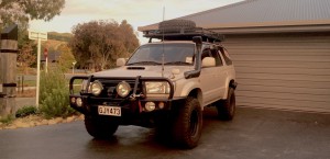

SHE'S BEEN LIFTED
Yesterday I managed to get the truck lifted with the supposed 50mm (2") lifted suspension kit I bought. After fitting it, the measurements from before and after actually indicate that it's more of a 60mm (2.36") lift - however I assume after a week or more driving it will begin to settle to a 40-50mm (1.5"-2").
I am quite impressed with the new coils and shocks - they seem to ride a lot nicer on the road than the factory ones and have certainly levelled the truck out a lot more. I must admit, given that the truck currently has it's Highway Terrain 265/70/16's still on it, it does look a bit ridiculous. I am sure she'll come up looking quite aggressive in a few days time once the black MCC Bull Bar and black rims are on.
My plan is to have a contrasting theme with the silver/grey against black features such as the bull bar, roof cage (which I am getting powder coated black), black wing mirrors, black door handles, black snorkel, black rims/tyres etc.
Image Image

they should be sweet but for piece of mind did you cycle the lifted suspension to make sure any of the brake hoses aren't being pulled tight :D

Hey Derk, yep sure did! Cheers for the heads up though mate

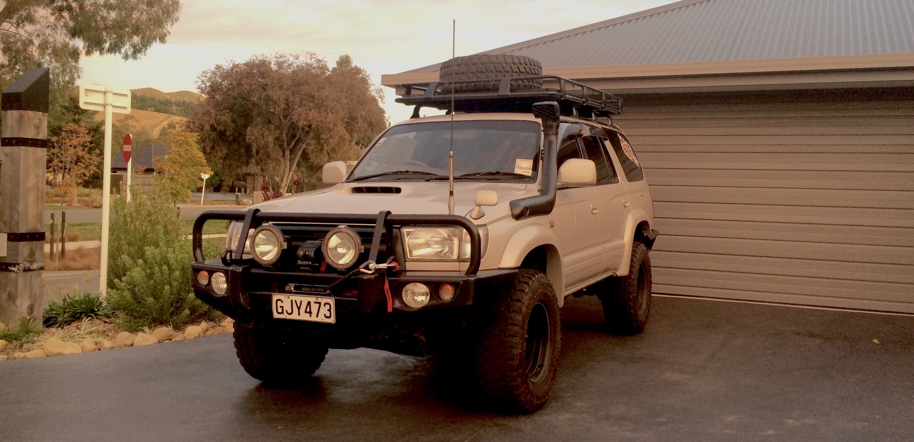

Re: Wild_South's KZN185 Surf (Quick) Adventure Rig Build
Post by Surf4x4 »
Nice Rig mate, good to see another tough looking Surf around. Here's a pic of mine, taken a while but finally got there.
Looking forward to seeing some more progress on yours.
