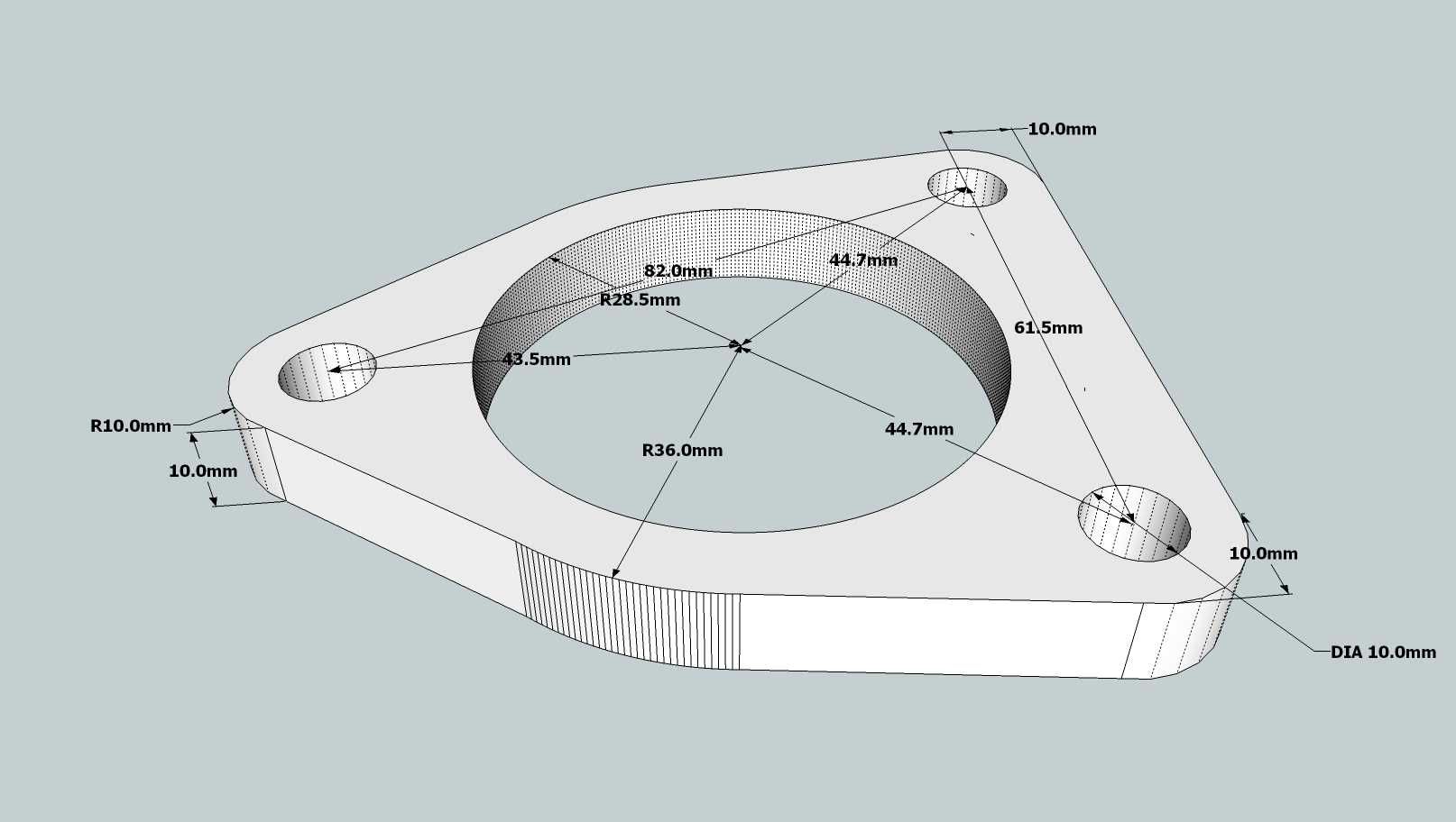

if your fitting IC and want to get rid of intake butterflies completely, get the manifold adaptor plate made.
centre hole i think is stock 2.25". make that 2.5" but you need to grind out the manifold to suit.

mine is nz new 2.8. manifold and is same size as the 2lte which came out of the surf.
i wish i ported mine out. 2.25" pipe is not all that common. 2.5" is easy to get.
i originally had 2.5" adapter on it. but as its a little bigger than the manifold, water/oil gets forced out at the 'step'. keeping them the same size makes pipe sealing a whole lot easier.
