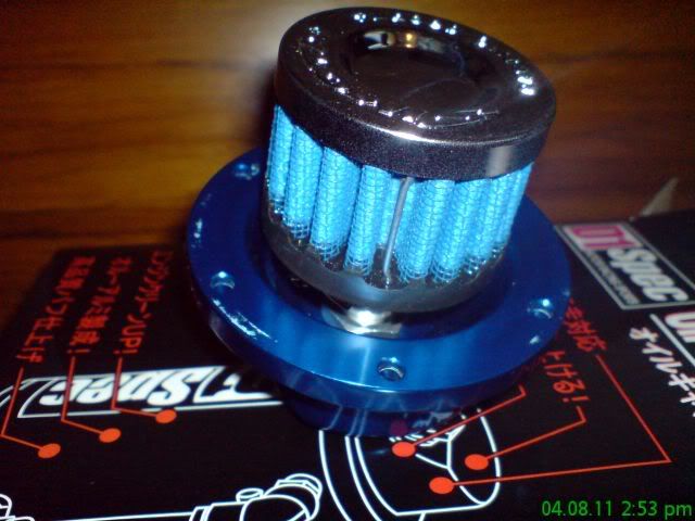

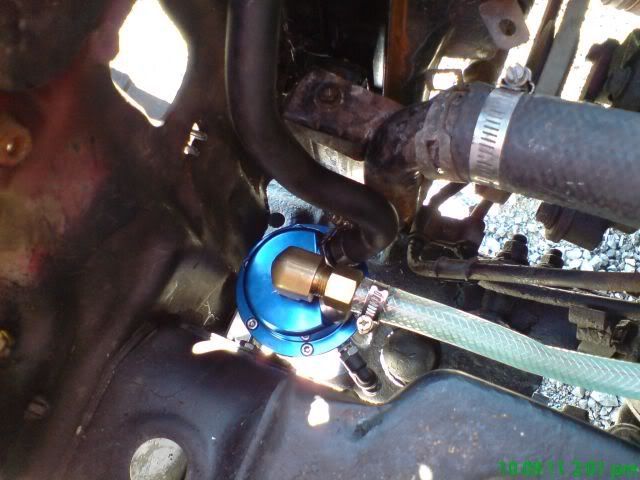

i've got two that i used a breather filter internally. one is still in use. havn't cleaned the filter in years!
but other one i had to disconnect due to water turning the oil to gray sludge and clogging up the filter.
