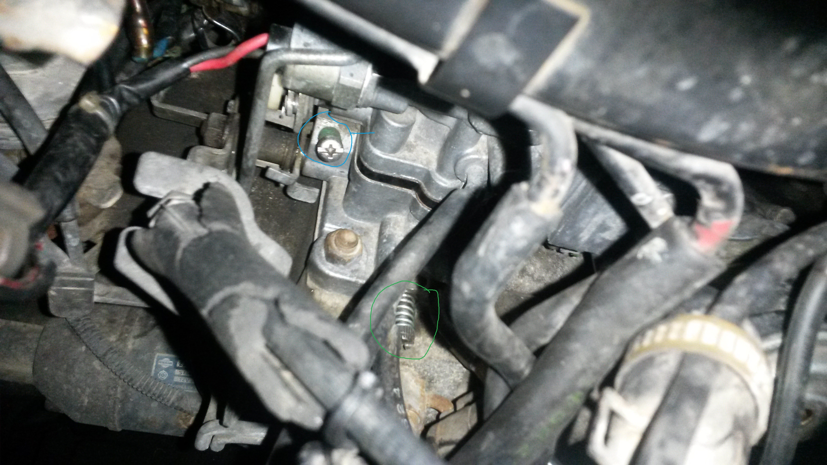

Could someone tell what the blue and green circled screws do exactly.
They are on the drivers side of the carb.
Picture 3, need to enlarge to see circles
Re: NA20 Carb issues?
looks like blue = idle speed and green = idle mixture
is the blue screw the stop screw on the throttle linkage

No blue goes into the housing just in front of the throttle leaver, located at rear of the carb.
Stop screw sits on a white plastic (kind of hour glass shaped) piece, which is controlled by the auto choke located at the front.
Does that make sense?

But yes blue did adjust idle speed depending on the mixture.
I actually altered the stop screw first. Now that's a pig at even with air filter and housing off
