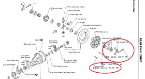

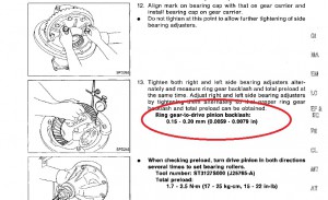

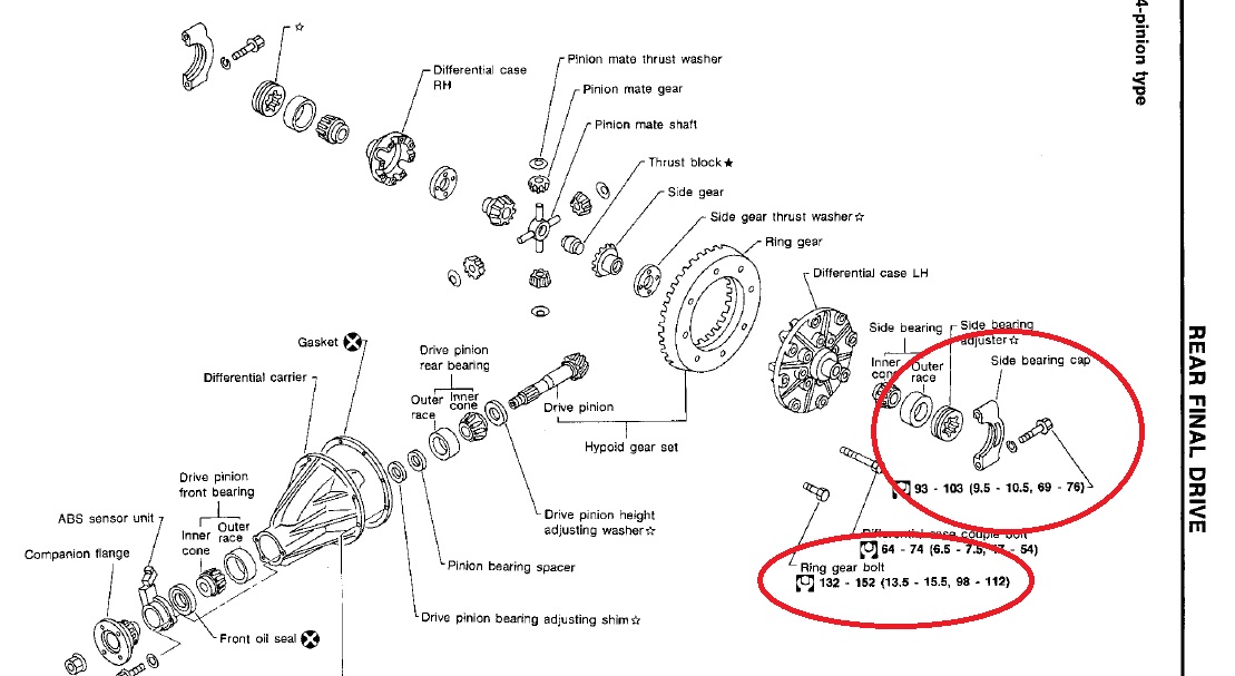

Hey all im after backlash crown wheel bolts and end cap bolts specs for setting up a Nissan Safari Rear diff can anyone help out as being a toyota owner im not sure :)
Doing the job for a local club member
Cheers Leigh

See attached
