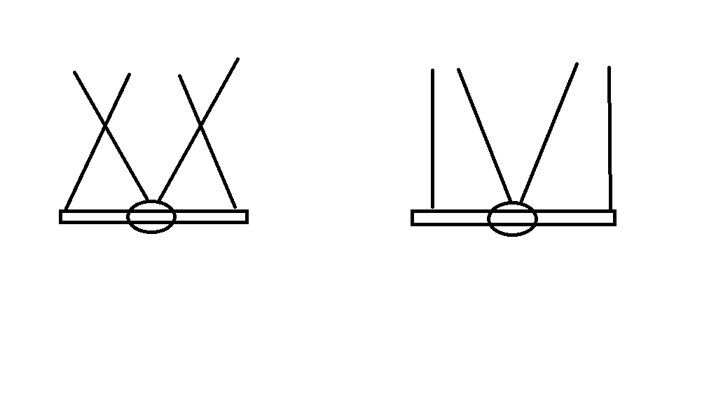

from experience which one of these is the best? iv got both made sitting in the shed but i just need to decide which one to go for. i want it road legal itl be on my daily driver.
any other ideas or advice is appreciated aswell
which is a better setup?

properly built double triangulated hands down,

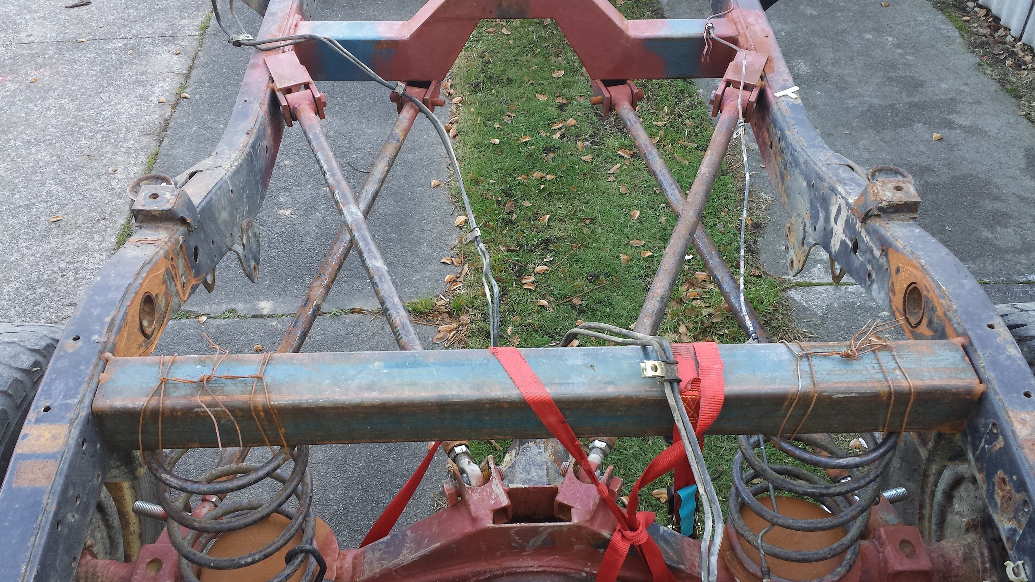

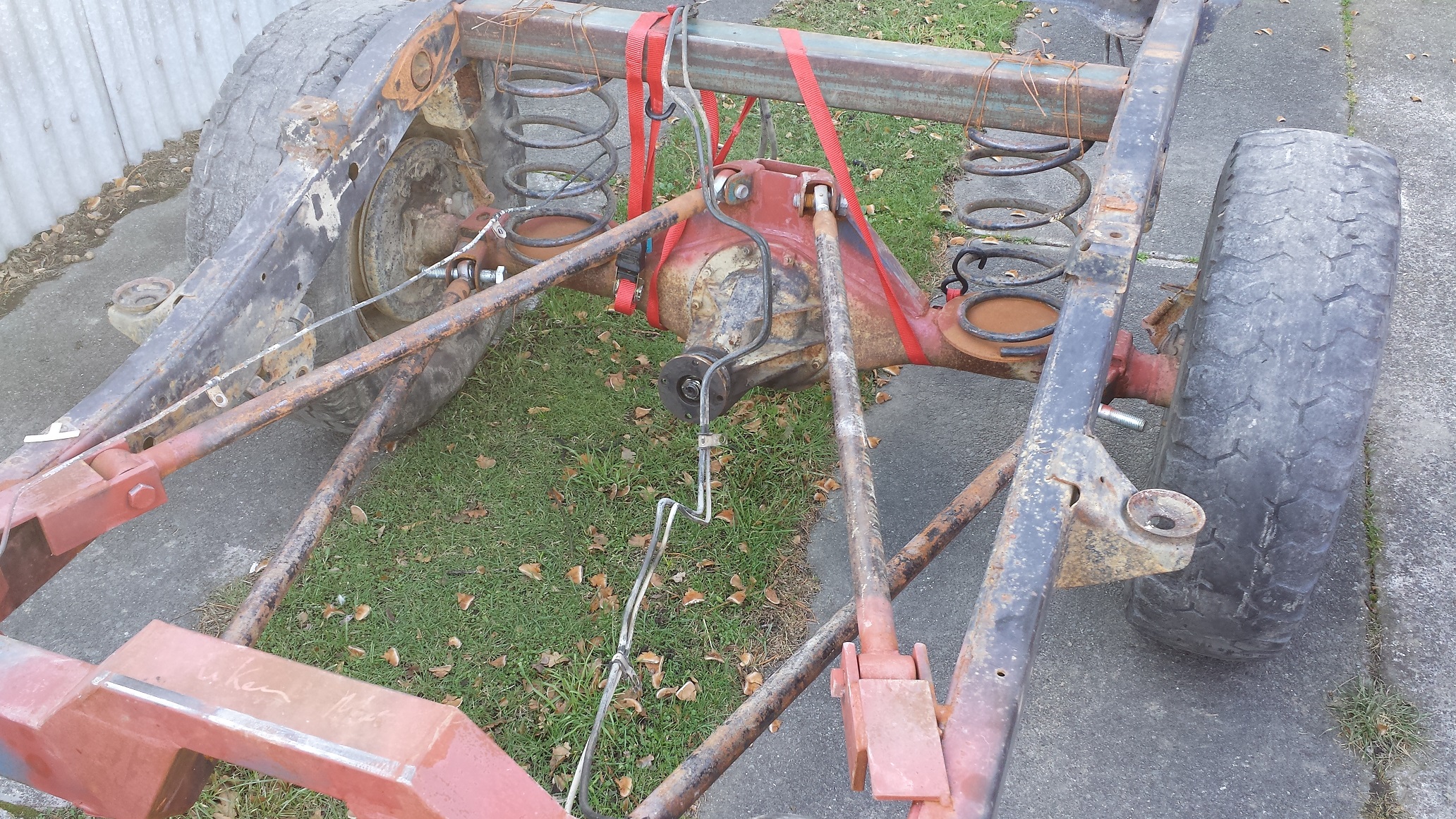

these are real pics of what iv got, that chassis is my jig basically im making it all to suit that then going to swap onto my ute.

The biggest advantage of the first pic is you won't have to run a panhard rod as if setup correctly you won't get sideways movement. The second drawing will if the lower arms are 90 deg to the housing.
Re: which is a better setup?
Both set ups do not need a panard even if the bottom arms are at 90 deg, the top arms form a triangle to stop sideways movement.
The first pic should give you less bump steer.

Yeah, what Suzolla said.
Single and double triangulation do not require a panhard. A general recommendation is a minimum of 40 degrees of separation between the upper links.
The advantage of double triangulation vs single (ie left pic vs right) is that your roll axis will change less as the suspension cycles. Also as Suzolla said, you will get less bump steer during articulation. All of this means less change in understeer/oversteer characteristics as your suspension cycles (pretty important coming into/out of a corner)
I guess an important thing to remember is that you probably don't need to build "the perfect four link" you just need to build "the best that you can fit", cause even that should be better than what ever you replace.
I'm building one at the moment. It will sit somewhere between your two pictures.
edit. I should add that the above info is all what I understand from having done a lot of reading, not from personal experience.
ok cool. my thinking is the other diff i have has all the spring and shock mounts, brake lines and everything already on it from factory. iv already got the arms made as you can see and it would be alot less hassle and cutting and welding mounting it into the ute like that. ill throw it together this weekend and see how it goes
