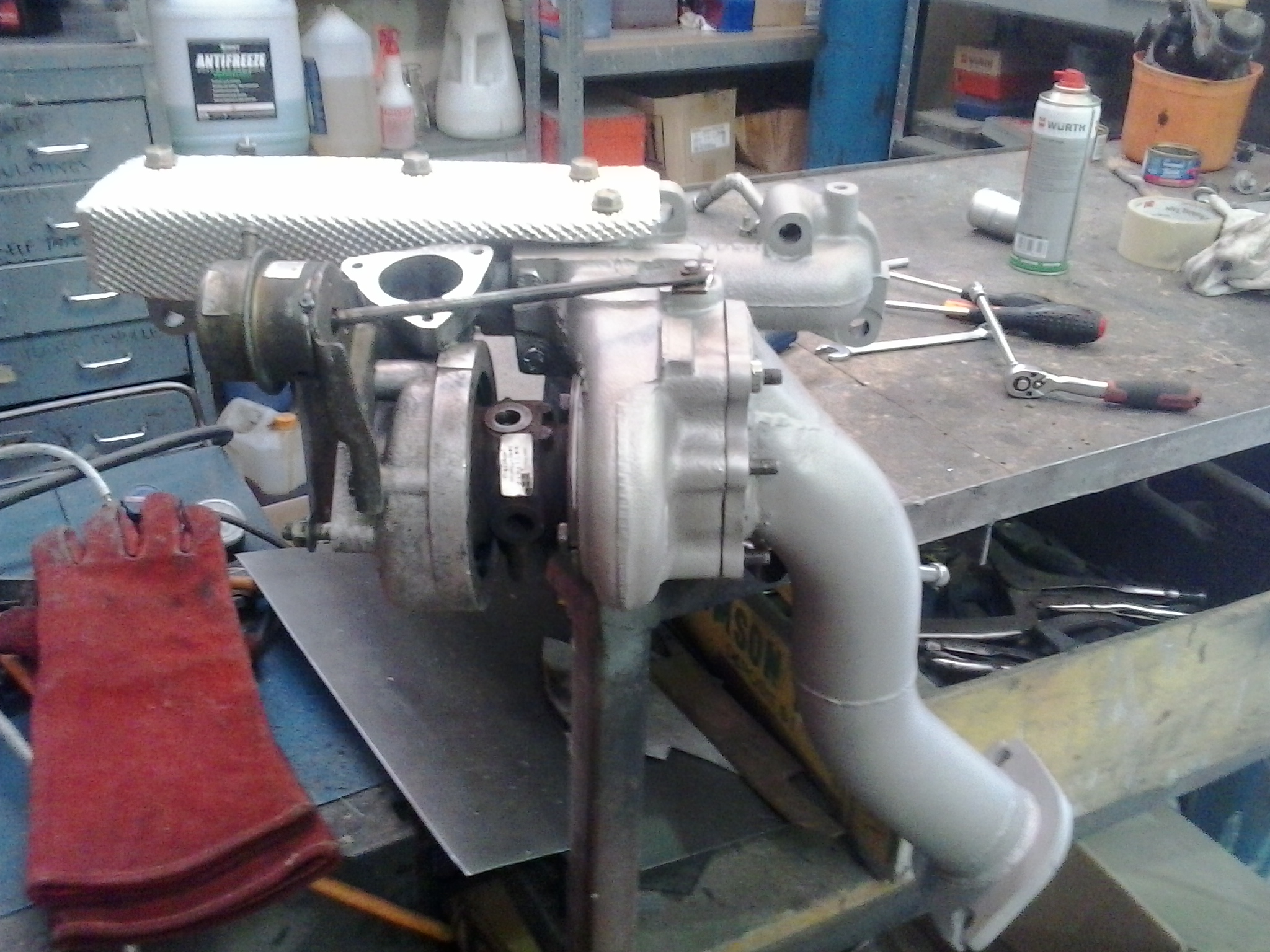

new turbo arrived today , everything is ready to bolt up and begin making the water lines.
Re: td27t water lines
Is that all brand new? Looks good best of luck with results
Trench_rat
- Posts: 147
- Joined: Thu Jul 29, 2010 9:01 pm
na mate just put a few hours into cleaning it all up and coating all the hot parts , the manifold is stock , the heat sheild is just made from a peice of scrap , the turbo is a stock nissan t28 ball bearing and the down pipe i made myself. Made plenty of progress today , the thermo housing now has a hose barb , the water lines are all made , all thats left to do is fit a hose barb to the block and then bolt everything together and hope for the best

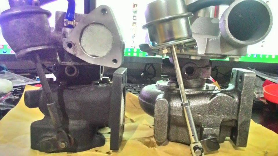

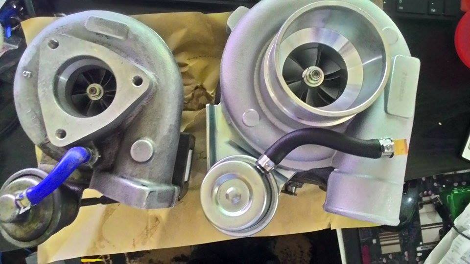

Bought myself a T28 turbo, It has the hose connectors instead of the flanges, The top outlet hose would be tight up against the exhaust manifold and couldn't get the bolts in.
Also i am selling it now because i am thinking it is to large for the little TD27T, I am looking now for a T25 Silvia turbo with the 2 bolt flange at the front and 3 bolt on top.
How does the T28 turbo go? Is there low down and high end power? At what Rpm does it start spooling? What is the max PSI you are running?
Trench_rat
- Posts: 147
i cant comment too much about how it goes as i havent tested it out too much. i originally intended on running a t25 but when this turbo arrived in the mail it looked overly large so i ran the numbers and it turned out to be a t28 ball bearing from a s15 silvia. It seems to spool just as guick as the little turbo i had on there to start with but it should hold peak boost right through the revs where as the smaller one would begin to drop off. once i have the boost gauge and controller hooked up i will report my findings
