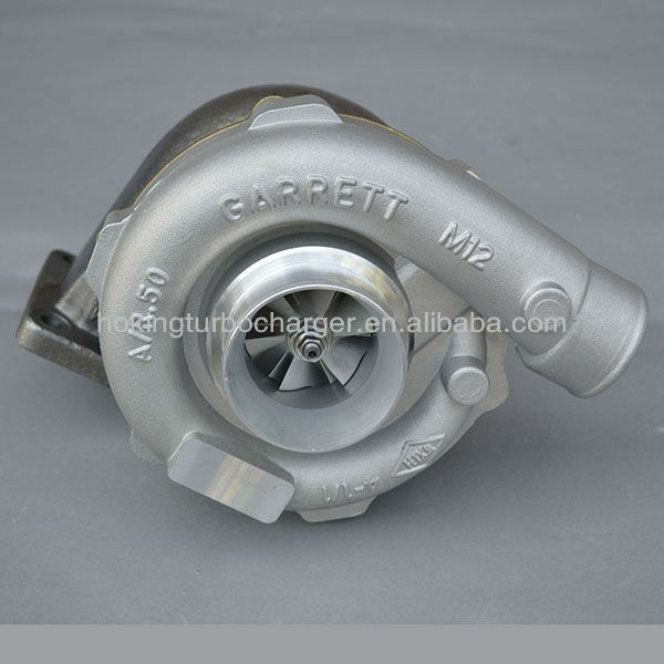

question for you, your turbo charger does it look like this...
or this...
The first is similar to the Hitatchi turbo used on earlier TD27's and are prone to shaft breakages, they can't handle too much boost or excessive EGT's.
The second is what you find on the late TD27eti's/ and QD32 with top mount intercooler and is much more reliable with constant high boost situations.
or this...

Mines the first one man, will try get my hands on the garret one. Does it require any modification? Lines, manifold etc
- Crash bandicoot
- Posts: 2924
- Location: Towing a hilux
Re: turbo swap!
tinyterranosaurus wrote:Mines the first one man, will try get my hands on the garret one. Does it require any modification? Lines, manifold etc
No, they share the same fittings.

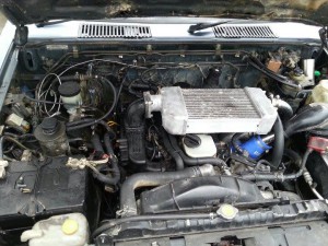

Hey managed to get my hands on a garret off the newer model engine. Found out though its got a bolt bolt flange that goes onto the exhaust manifold. Guy told me it would fit so i fucked up and didnt double check. Think its off a zd30 or something. Am i able to chuck the manifild for that engine onto the td27? Otherwise would this turbo run good cause i can modify my manifold for it to fit if itll run good on it. Turbo seems really good condition. Thanks in advance
Re: turbo swap!
got a pic of it?
or any numbers off it?
zd30 are hitachi turbo unless its a variable turbo which are garret. zd30 manifold won't fit a td27.
- Crash bandicoot
- Posts: 2924
Re: turbo swap!
if it is hitachi like your original one you may be able to swap the exhaust housing/propeller if the cartridges are the same physically
- Driver/Navigator
- Posts: 16
- Joined: Fri Jun 12, 2015 7:08 pm
Re: turbo swap!
Did some further research and asked a diesel mechanic and confirmed wouldnt fit so i ended up making my own flange and welded it to the manifold. Got everything back together but now got to deal with a high idle issue before i can give a review haha will post pics up soon!

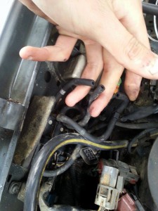

these are the vaccum lines that were connected to the egr butterfly etc, had them blocked off but took them out to show you whichs ones the the solenoids.
