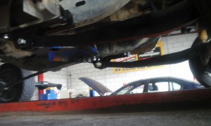

cheers to nathan at kaiapoi repowers buds long arm kit arrived the other day

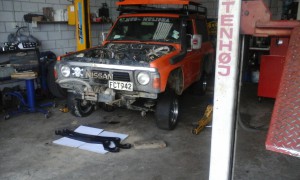

going together this weekCheckerhead wrote:Pics?
Re: radius arm mods

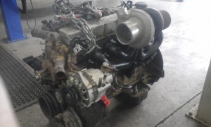

works going well massive birthday for orange
Re: radius arm mods
Thats quite a big whirly blowey sucky thing on the side of the motor!
Re: radius arm mods
yeah it is my concern at the moment. its .55 ar cold side an unknown hotside. smallest t3 twin scroll i have though. guess ill find out tuesday when wheels go on.
the buds kit is awesome to look at and has completely nailed my front driveline alignment castor issues. gearbox dropped a tad but longer lower arms to go on ( both mine slightly bowed)
