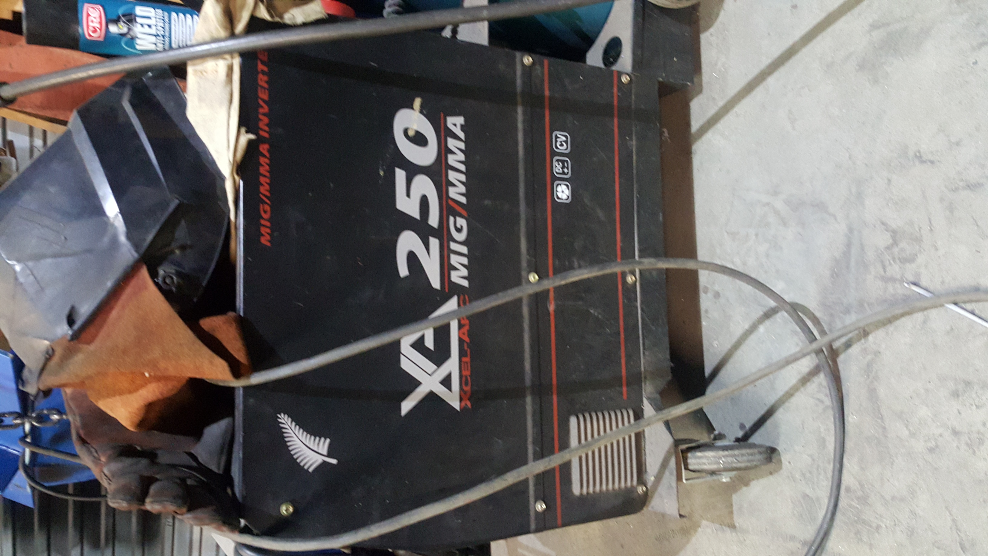

I have one of these welders http://www.trademe.co.nz/business-farmi ... 489953.htm (didnt pay 1/3 of that price tho) and its been an awesome welder to learn with.
Run C02 with it. have welded exhausts, tow hooks, patched rust holes and my mate has even made a bumper and winch mounts with it. Can weld upto 8 - 10mm steel if u have to but wouldnt want to do it all day.

Im a Tumor wrote:I have one of these welders http://www.trademe.co.nz/business-farmi ... 489953.htm (didnt pay 1/3 of that price tho) and its been an awesome welder to learn with.
how do you find welding with co2?? im considering using it for my mig i just bought but just not to sure how good it is? seems to be alot cheaper than getting a bottle rental and buying argoshield. do you have to run a special wire with co2 or will normal mild steel mig wire be ok??

You use normal solid wire with Co2. The weld won't be as pretty as Co2/argon mix but will still do the job well.
