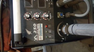

I have one of these welders http://www.trademe.co.nz/business-farmi ... 489953.htm (didnt pay 1/3 of that price tho) and its been an awesome welder to learn with.
Run C02 with it. have welded exhausts, tow hooks, patched rust holes and my mate has even made a bumper and winch mounts with it. Can weld upto 8 - 10mm steel if u have to but wouldnt want to do it all day.

Im a Tumor wrote:I have one of these welders http://www.trademe.co.nz/business-farmi ... 489953.htm (didnt pay 1/3 of that price tho) and its been an awesome welder to learn with.
