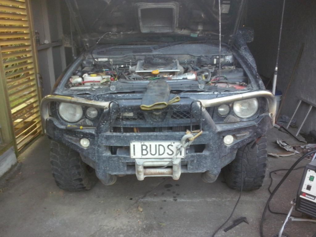

yeah if you have seen my engine bay...haha, there aint no picture of it unless i start removing shit, the 2nd battery along with the split charging system/harness on that side aswell as the modified air filter box, oil breather recirculation system, twin fuel filters, Air compressor line's, intercooler and it's shroud oh and if that isnt enough the abs unit too. i think there is more crap on that side then the drivers side.

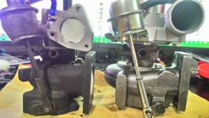

So its one of these?
And not one like this?
The pump ive got is standard and dont have much money to be getting it modified to the 12mm plunger.
Don't know why im getting such bad fuel economy.

So I had a closer to look at it today as best i could, and compared it to the rest of the junk factory turbo's i have and i am incorrect in saying its R33, it is nissan but not skyline may have been off one of my SR engines from my race car i had a few years ago. how ever "the shoe fits so wear it" mentallity in me bolted it on to the TD because A it has bigger compressor side and B it fitted.
