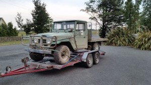

I'm restoring a HJ45 flatdeck that I bought for spares for me mud truck, it turned out to have so little rust that I couldn't bring myself to break it.
It did have a 3B lashed into it instead of the H so that has come out and will do duty in the other toy :)
The chassis has been sand blasted and epoxy coated after cleaning up the mess of the other engine mounts.
It's down to the last nut and bolt on the body and I have a few repairs to do before getting it painted, that's the only bit I don't want to do myself.
I have restored cars in the UK many years ago but I am new to tig welding. I need to improve my prep, gas welding was much more forgiving!

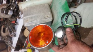

Just noticed the 70 series side lights on the guards.
Hmmm food for thought for me... although I do have some taiwanese copies of the 40 series ones for my one.

Heath wrote:Just noticed the 70 series side lights on the guards.
The lights are normal square ones fitted onto the bonnet sides instead of the guards. They are faded all white! I have got some genuine early round ones from ebay. http://www.ebay.com/itm/351424837384

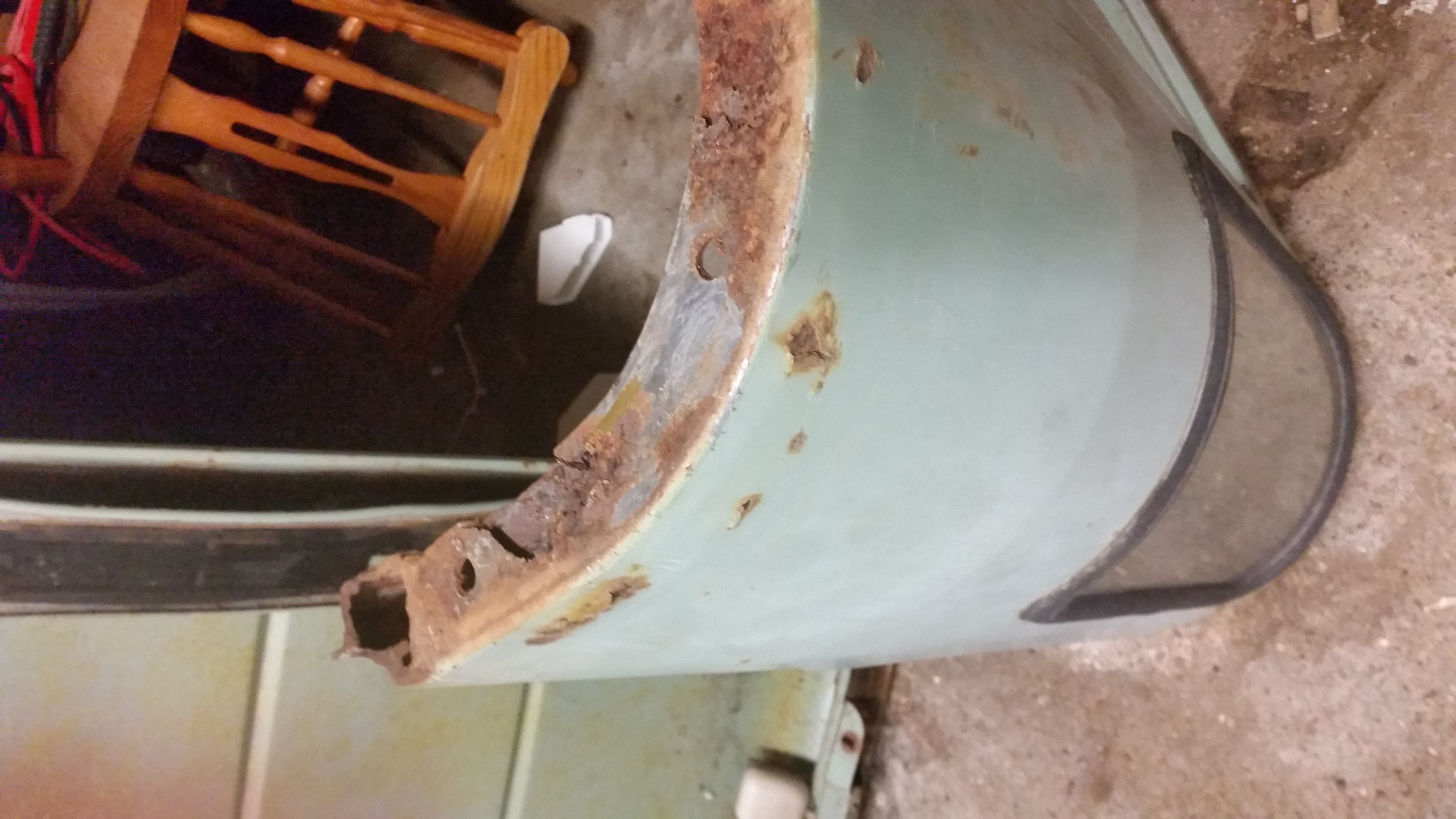

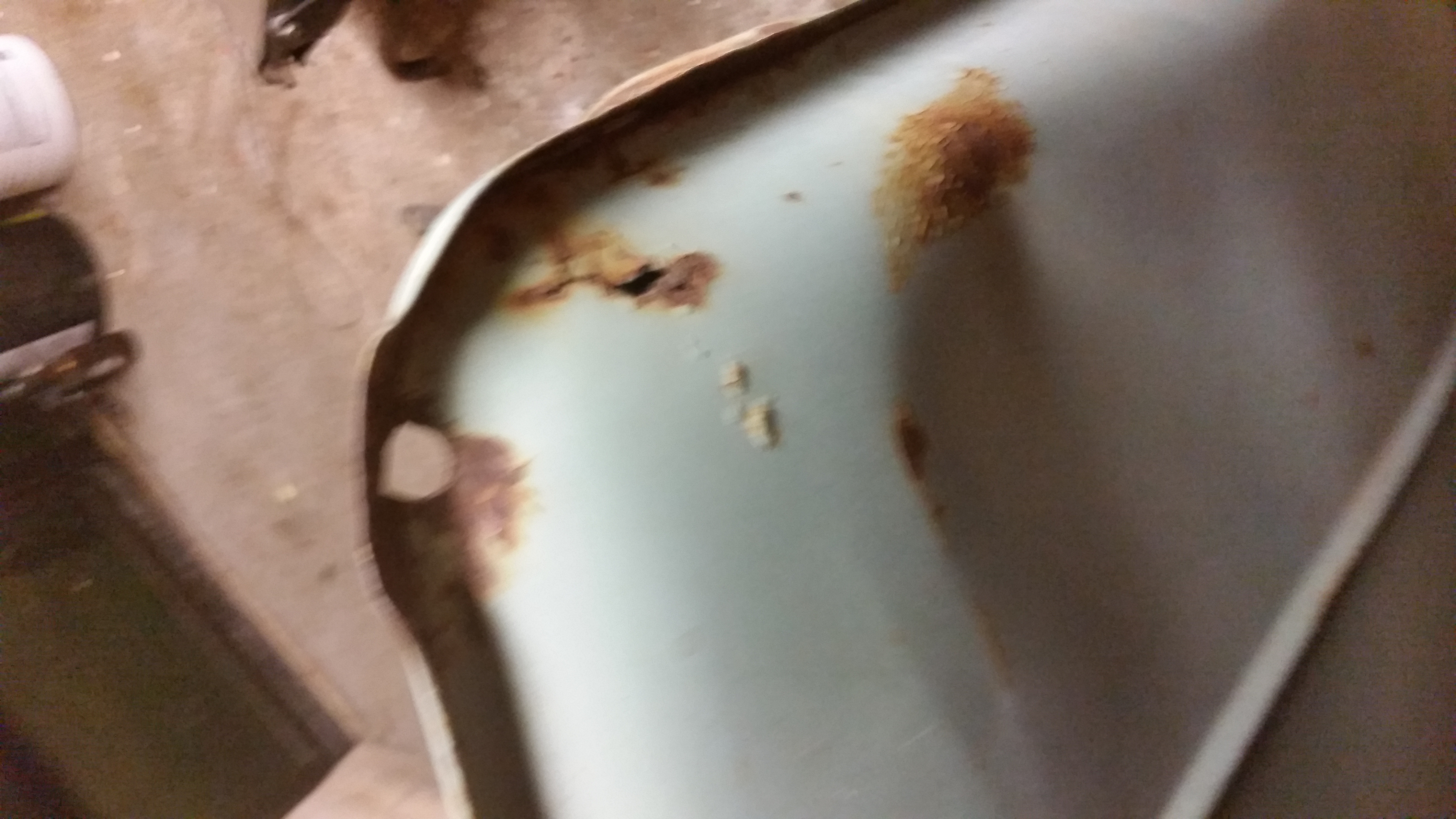

I've got the tub welded up, now to start on the other panels. There is nothing too scary but you can see why these rust so bad usually, there is not even any primer on the joints, just bare metal.

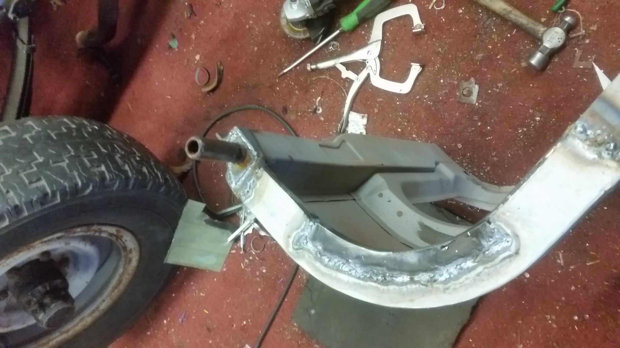

I have snuck in two chassis repairs before getting it coated, the weld above the rear cross tube was cracked and a bit of rust where the chassis kick up starts.

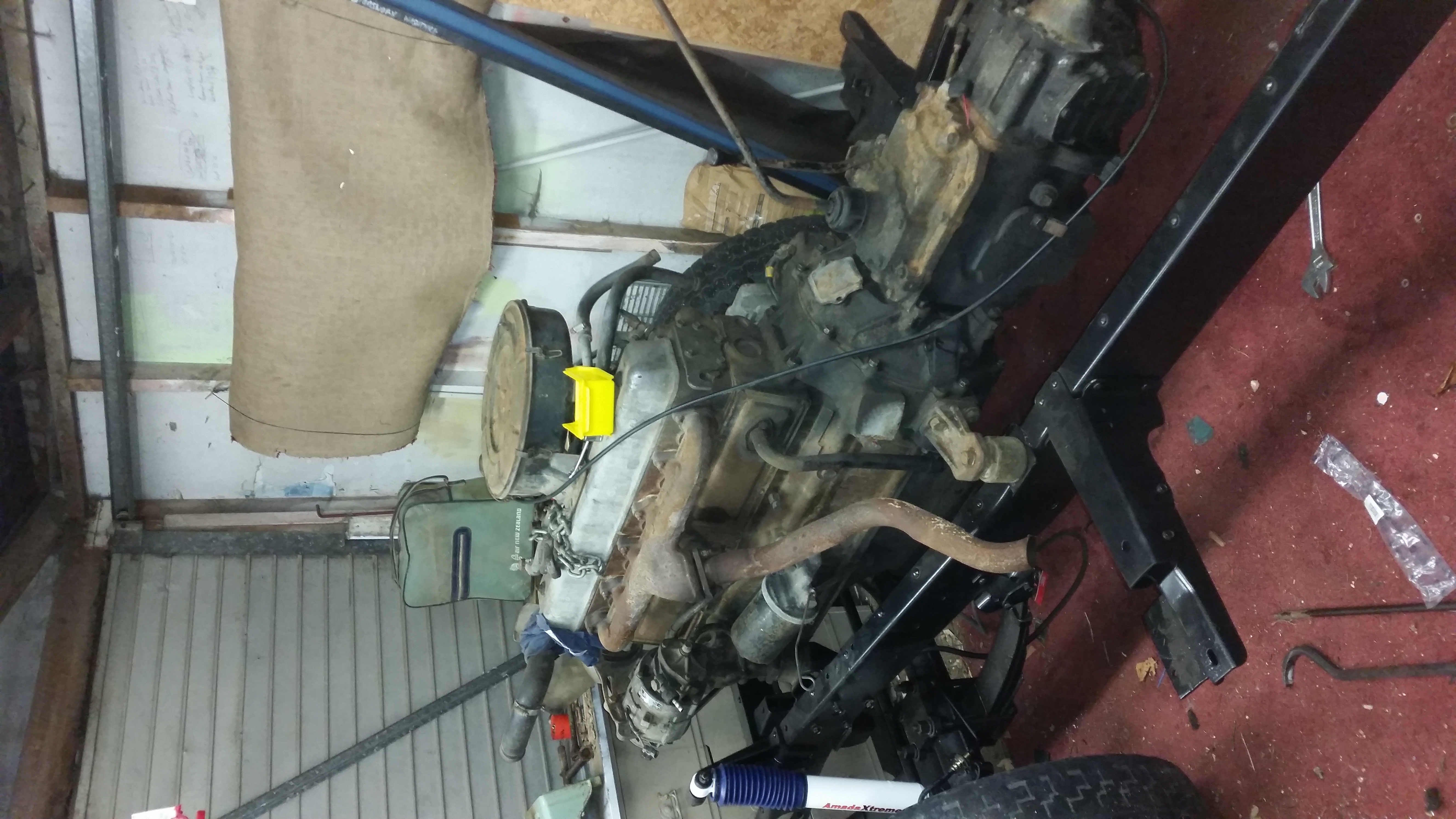

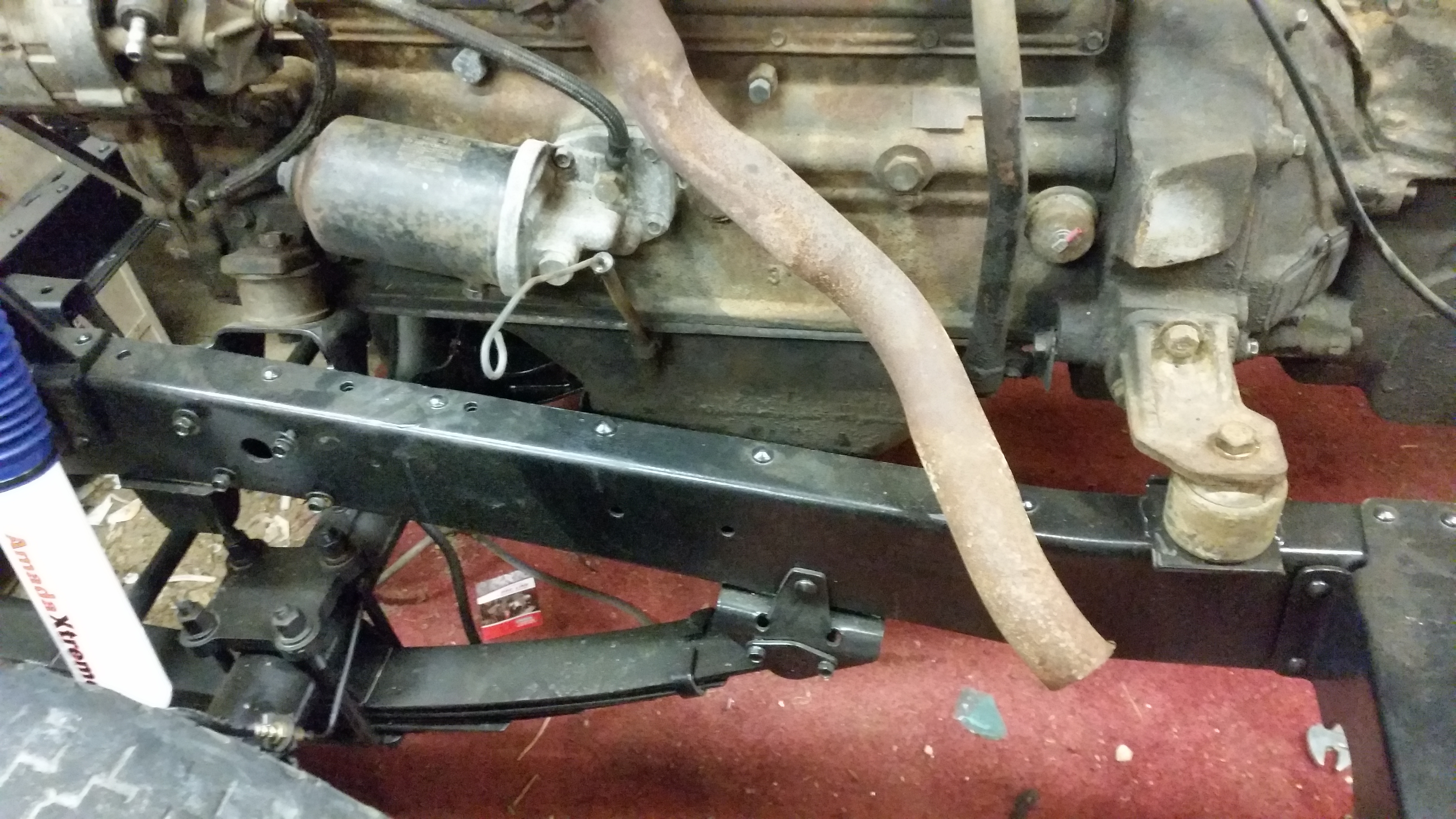

I've thrown the engine back in, fitted some new shocks and brake hoses.
These are the engine mounts

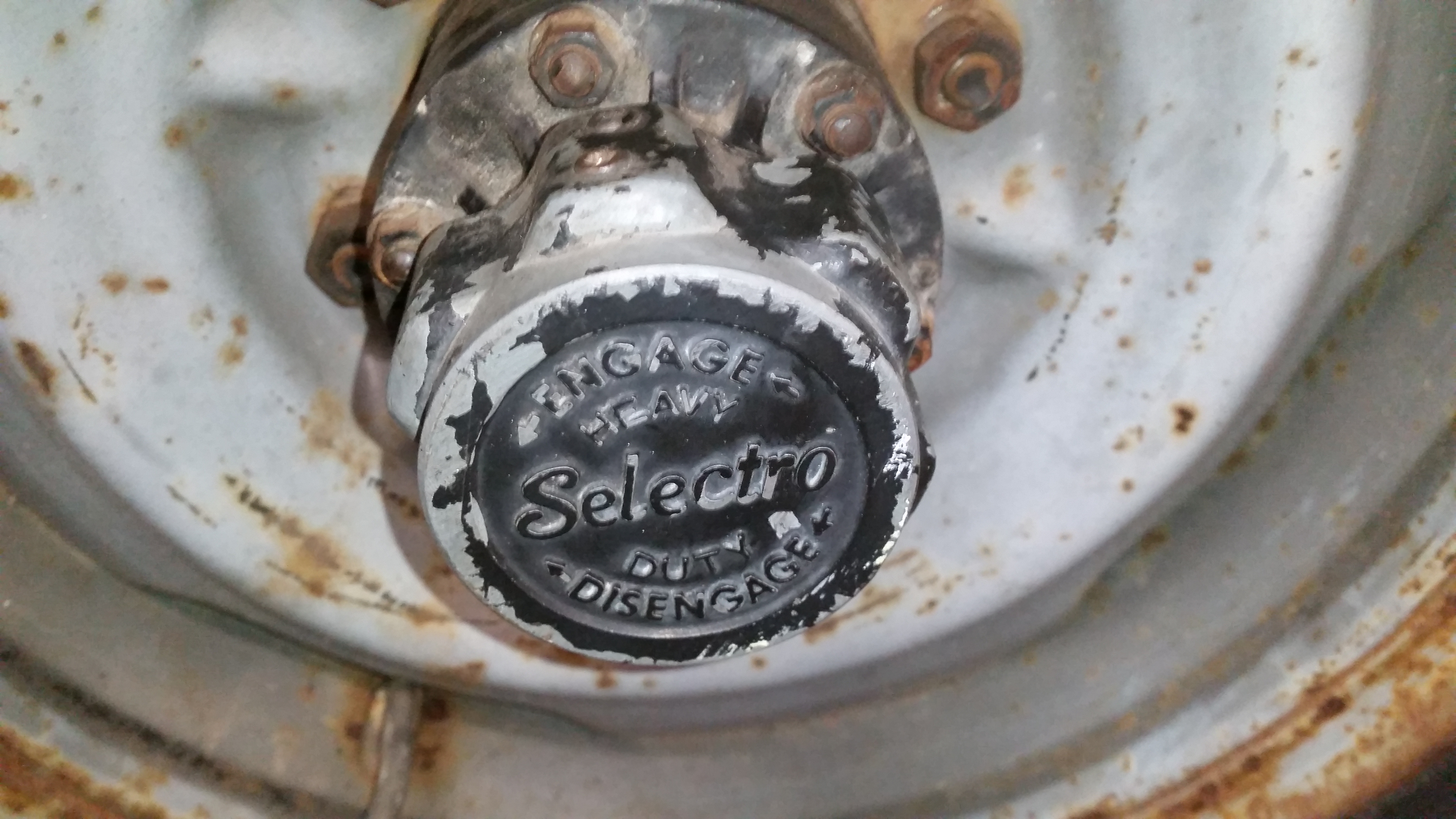

Has anyone seen any free wheel hubs like this before?
All the green bits have gone to the blasters and painters. I still have rust repairs to do on the roof and rear windows but they will get done after blasting to get all the rust out.

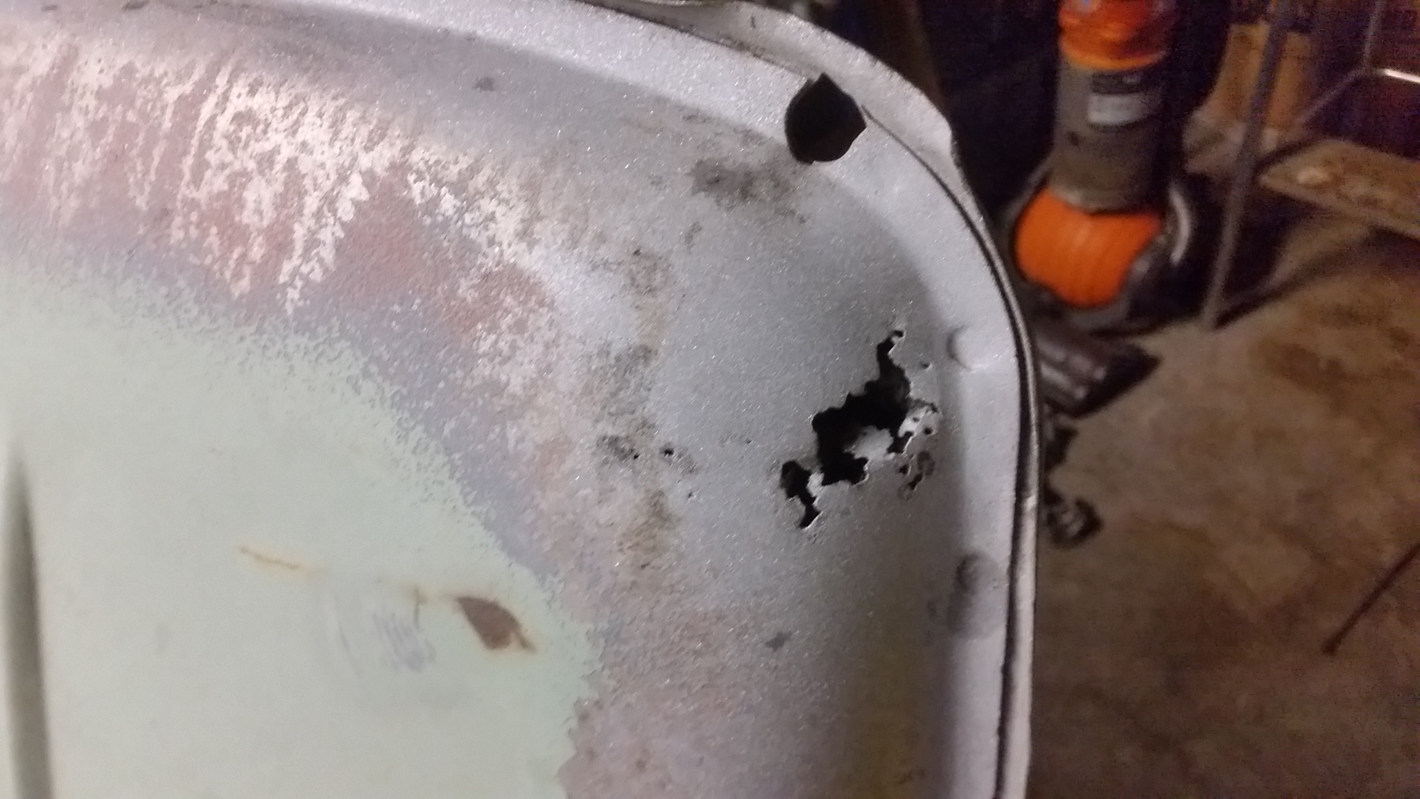

Yes it's the bit with the rear windows that is the worst bit on the truck. I'm going to have to make the upper triangle box section along most of the frame :(
There has been no bog, some painted over aluminium tape, but no bog!
Now your rebuild is heading to the dark side - I googled "selectro free wheel hubs" and got crazy poms debating if the bolts were BSF or whitworth ( the thread originator was hammering metric sockets on Ha)

diogenese wrote:Yes it's the bit with the rear windows that is the worst bit on the truck. I'm going to have to make the upper triangle box section along most of the frame :(
Mine was swiss cheese and looked like the guy was sponsored by a filler company. He did a fantastic job though as it wasnt easy to spot until the blaster got into it.
Seems the bits where panels bolt together are almost devoid of paint or protection and they seem to be susceptible to water pooling. Might use some windscreen sealant to glue things watertight when the time comes.

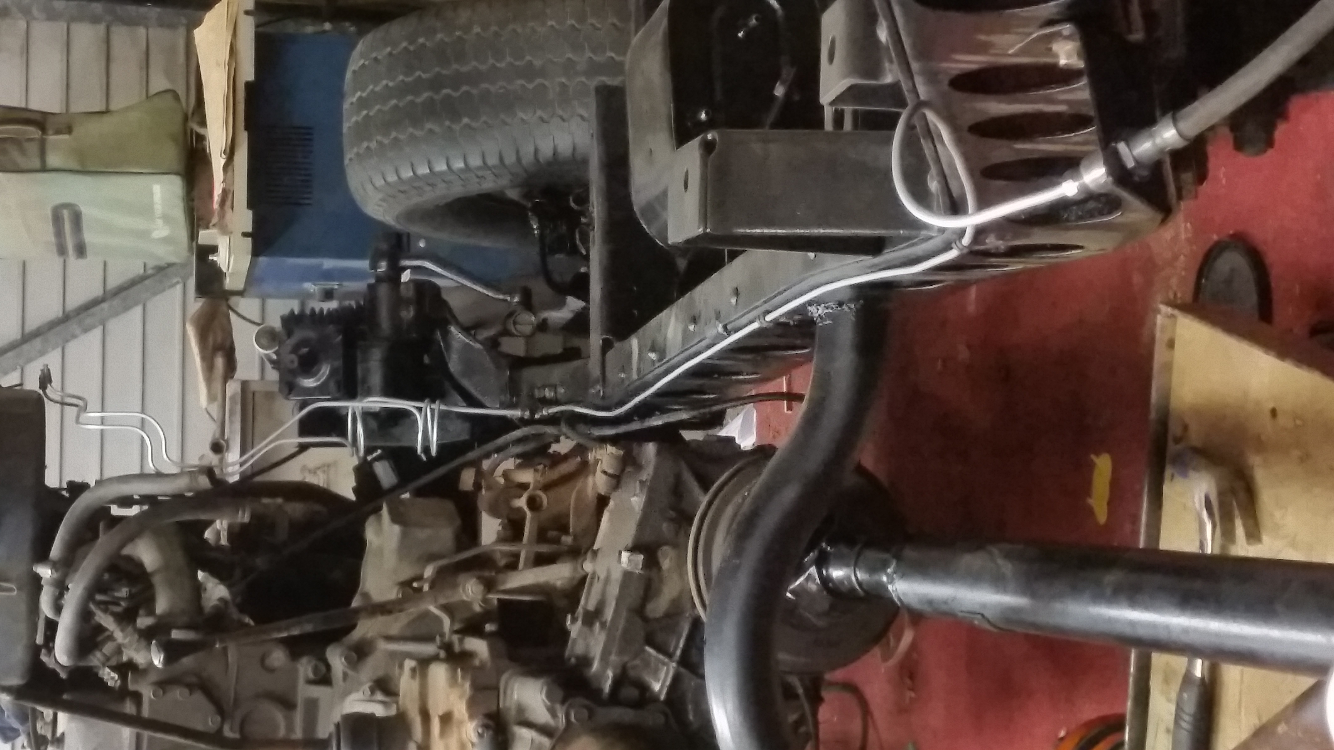

I've made new brake pipes, mainly because the old ones had been adjusted too many times and were very hard.
A few more bit and pieces have gone on but I'll be back to welding again soon.

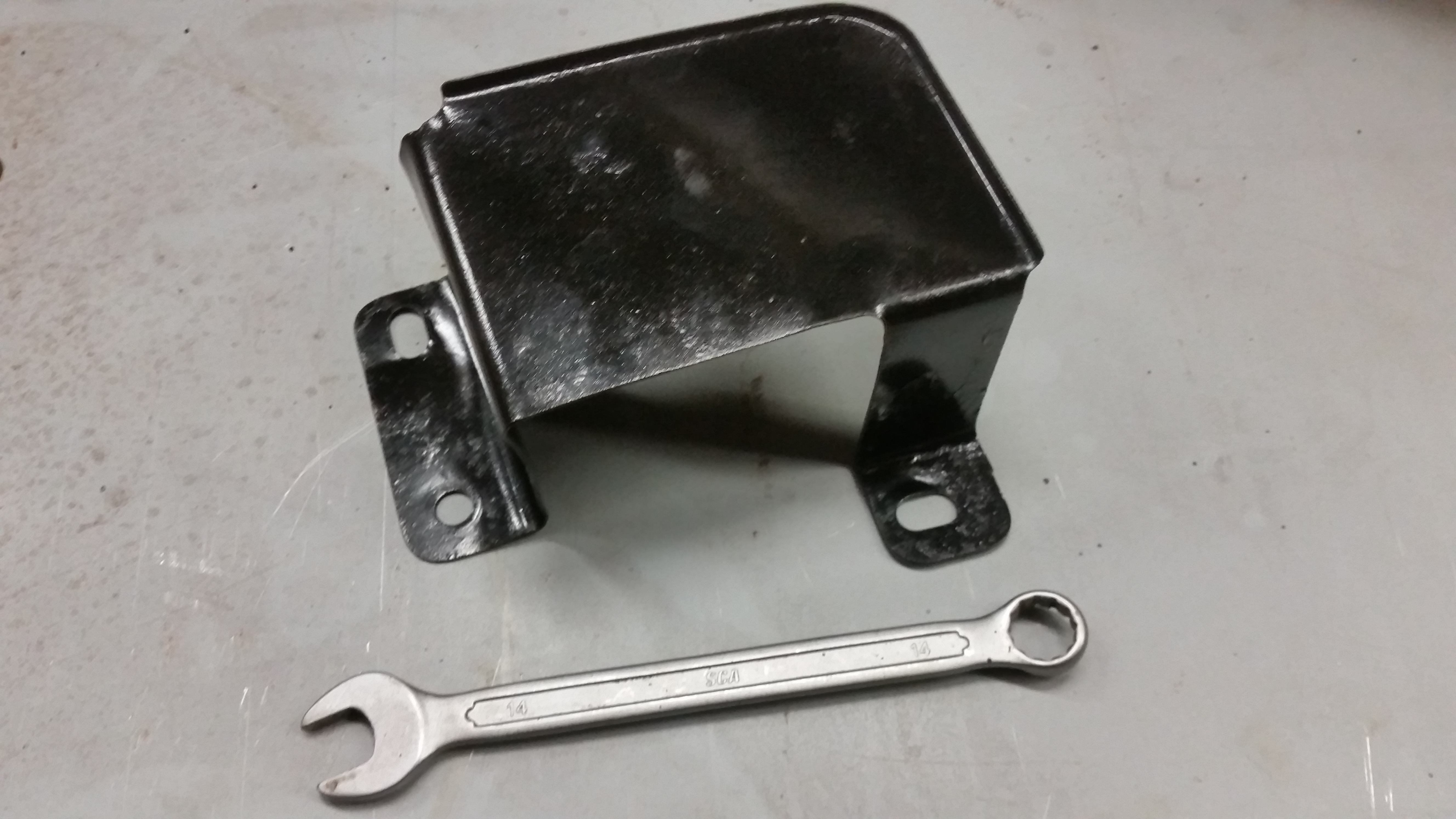

Does anyone recognise this little panel? I've cleaned and painted it but I can't remember where it came from!

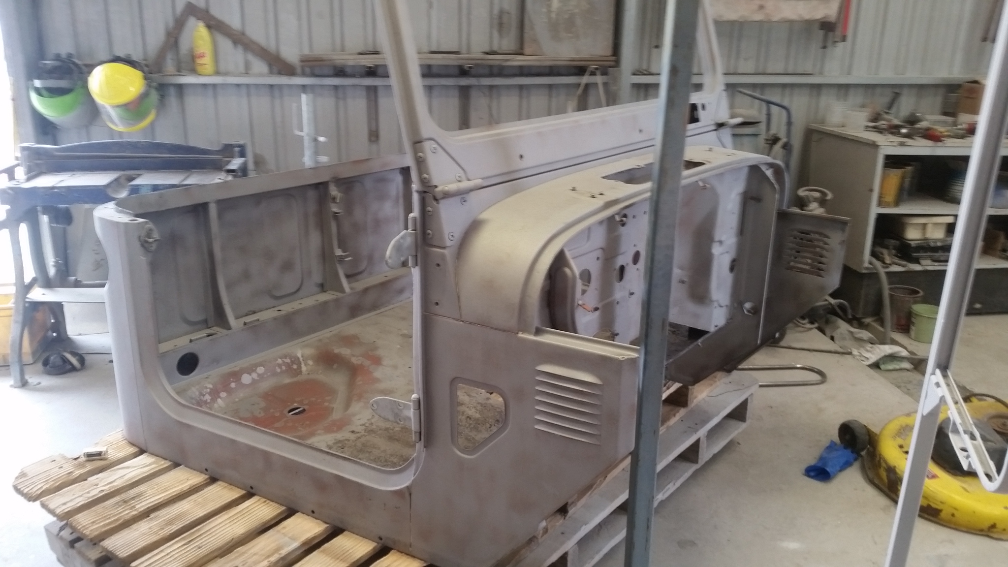

I've finished up with the welding now, just got to get the last two panels back to the blaster and start to get stuff painted.
I have got a few pics of the repairs to the window panel.
One corner of the roof was full of bog, I had it blasted so I knew how bad it was going to be. Pretty good was the answer, only two patches needed.

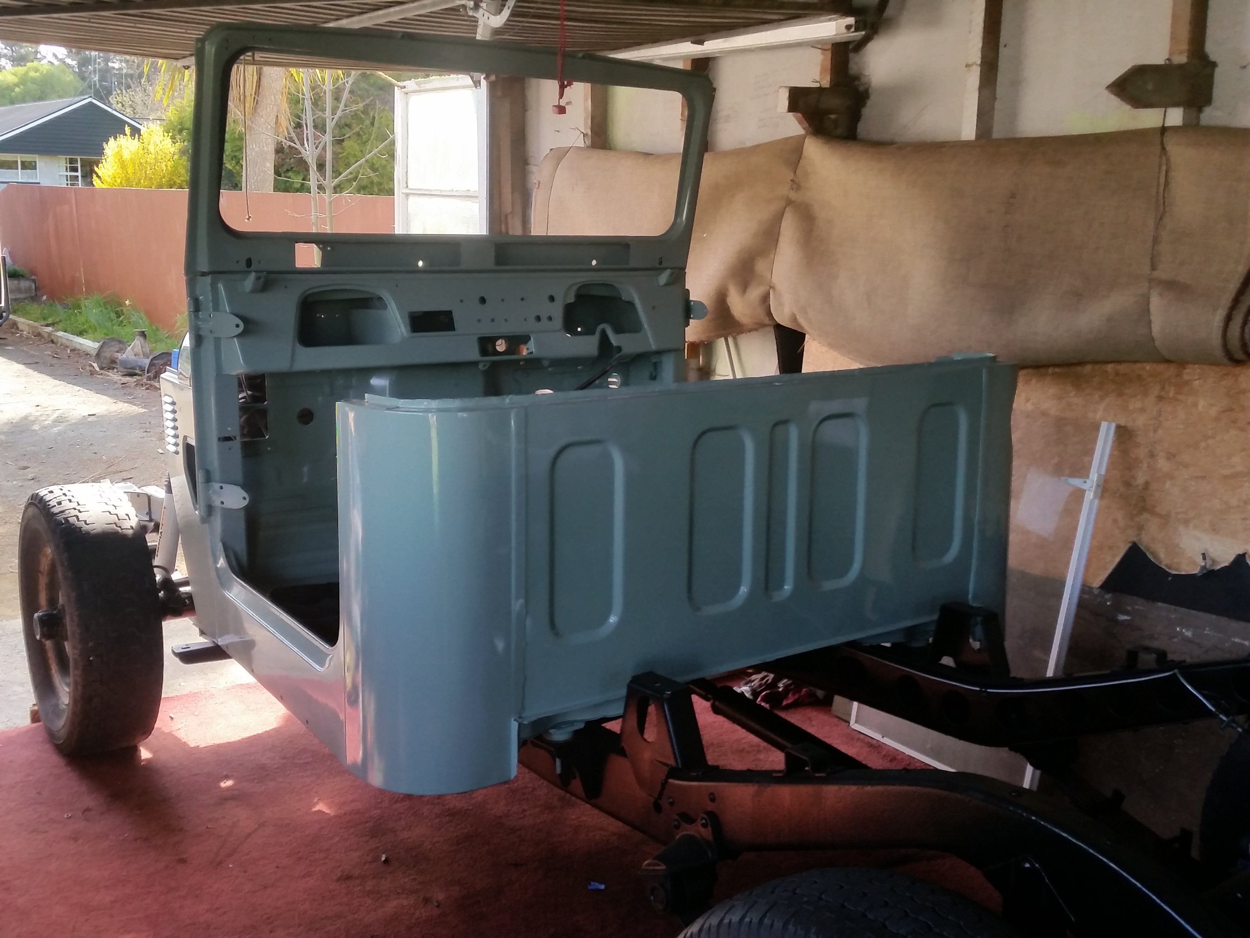

My tub has been painted, the rest of the panels will be done later.
I can now fill up the cavities with fish oil and fit it to the frame and pretty much get the beast running.
The rest of the parts will get painted later, apparently insurance work pays a higher rate than I am ;)
