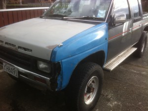

before shot
before shot

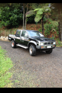

so ive got this ute it has a non turbo td27 manual in it and i have a turbo td27 terrano parts truck so needless to say the turbo setup is going in the ute along with the bonnet and flared terrano front guards,half pie considering cutting the rear flares out of the terrano and stitching them onto the well deck of the ute hmmm,will update with pics as i go cheers
