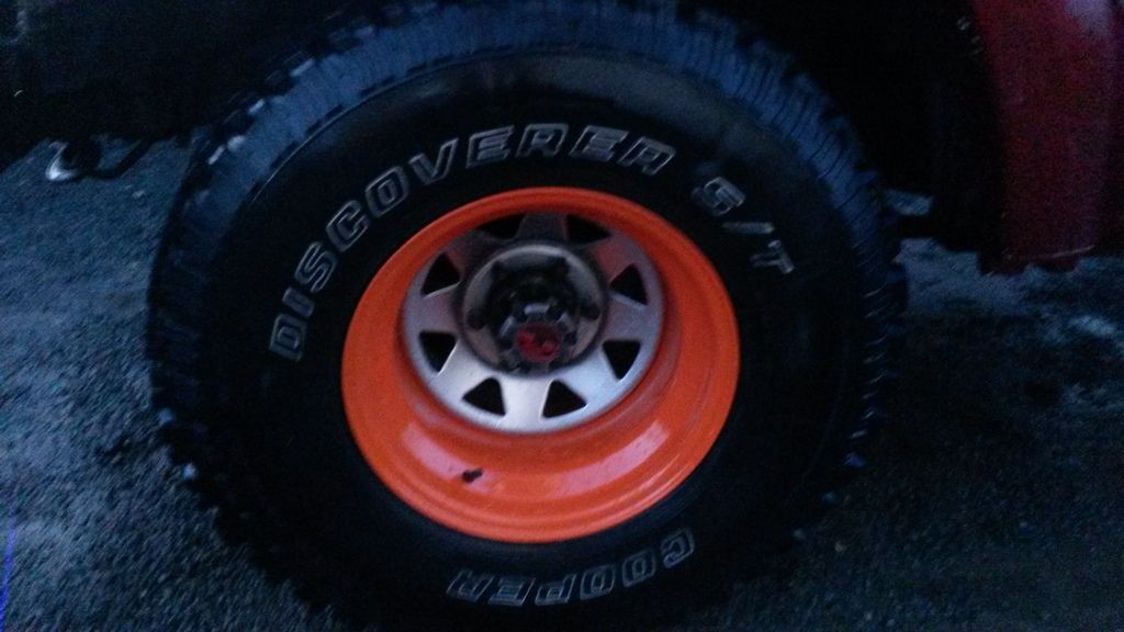

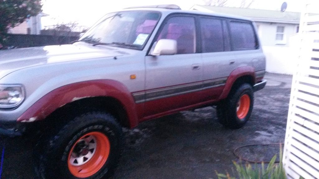

I sourced some 15x10 rims for the road tyres and after a sand blast they got the orange and silver treatment.

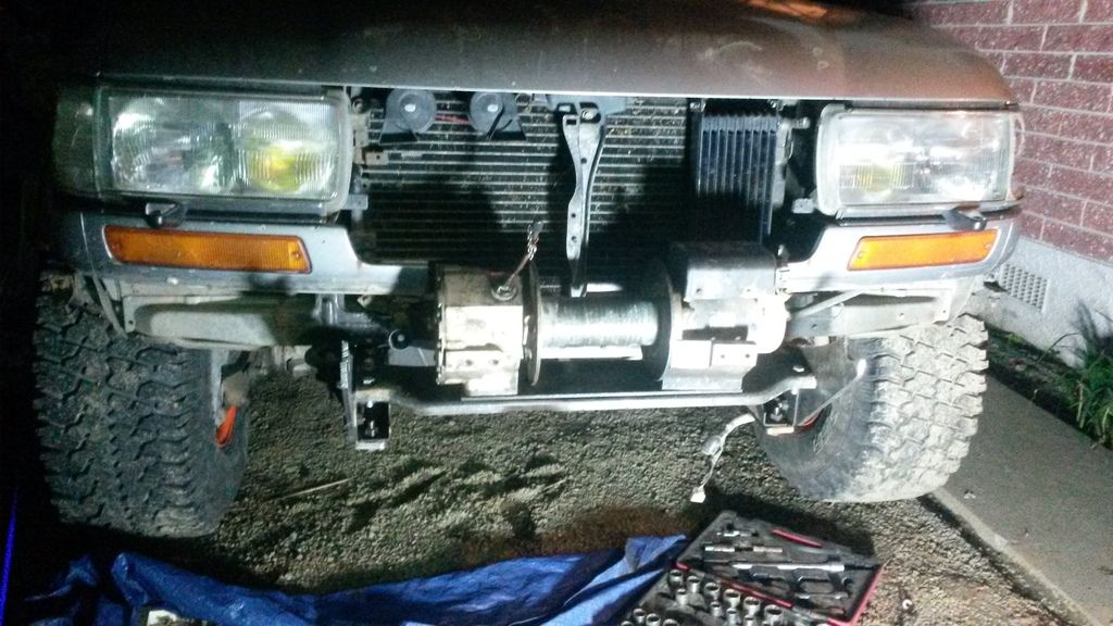

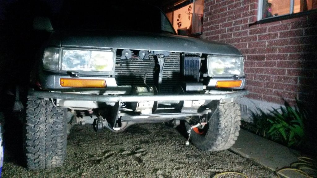

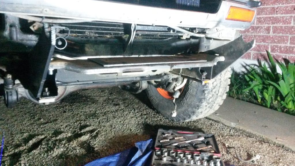

Next on the list was to remove the front bumper for a more suitable front bar,the first night every thing was stripped away and it was decided to lift the winch from the bottom of the chassy to the top.
Then the brackets to hold the bar were fabbed up and the winch mounted after the body surround was cut.

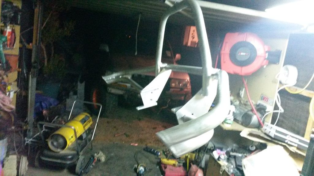

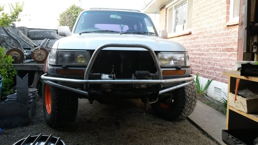

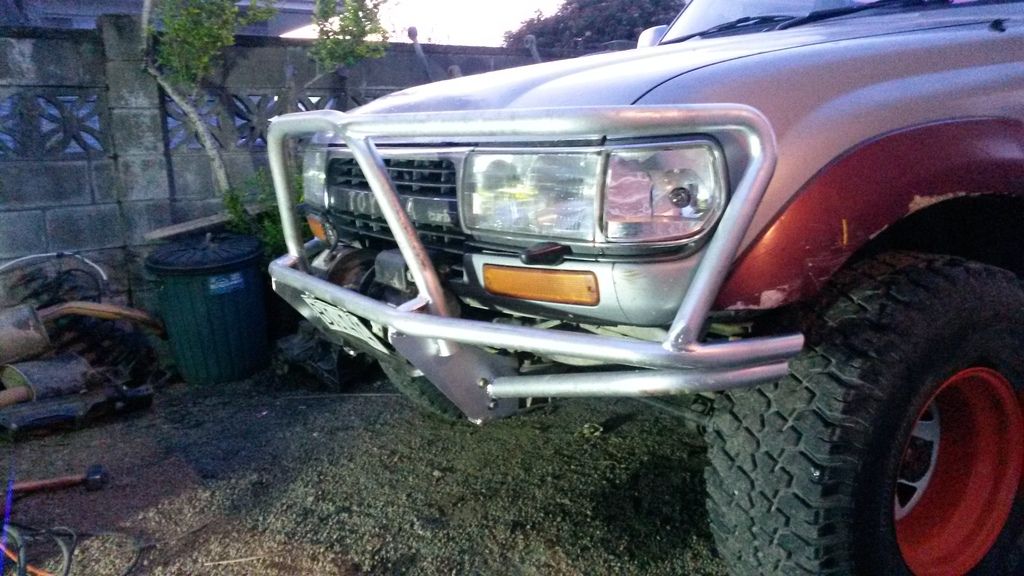

The Second night after the pipe showed up (i used 32NB sech40 galv pipe 3mm thick approx) the bending started first time i have used an good quality alloy die and dont think i will go back, first the base bar

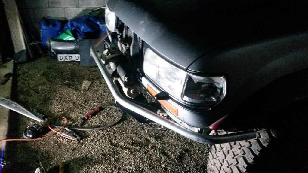

And buy the end of the night had the hoop and bottom braces all tacked up to dark for photos at night.
Pulled it all off and welded it up then some bright zinc on the welds the next night.
imsohi
Posts: 727
Re: Project Buster
Post by imsohi »

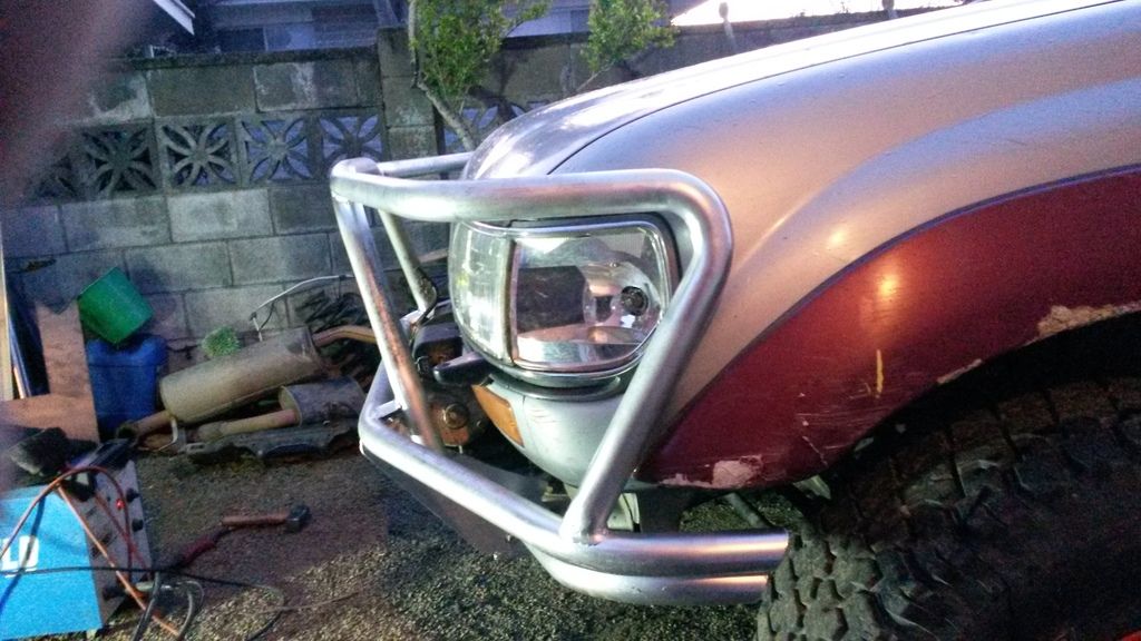

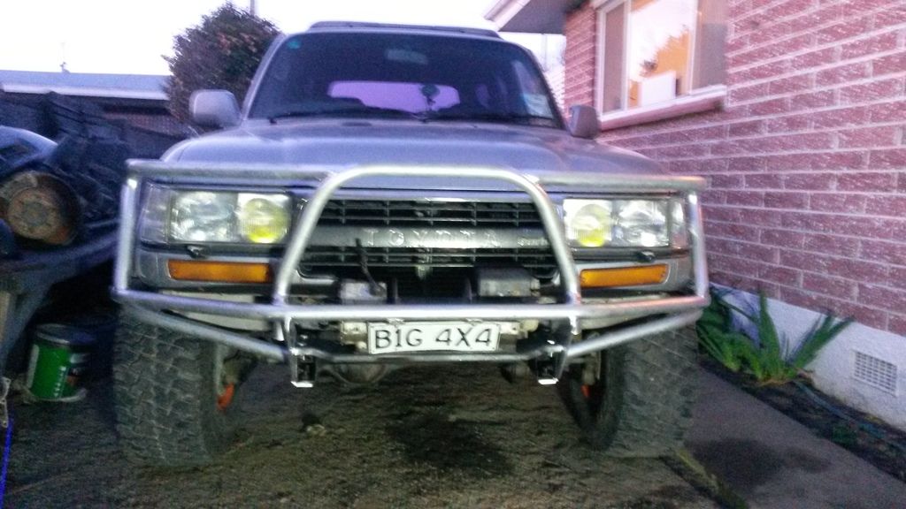

And finally tonight made the wraparounds i used weldable bends on the tight corners
I still need to finish the mounting of the winch and a fairlead and also a lightbar but i have a hilux which is in need of some urgent attention before the upcoming winch challenge.

Post by UBZ »
Nice Fab Work!
Are you going to brace the corners back to the Chassis?
If you hit some thing as they are, the corner will fold back and the wrap around bars will munch the guard behind.
Don't ask me how I know this :? :roll:

Post by imsohi »
UBZ wrote:Nice Fab Work!
Yea is on the to do list just got sick of the original bumper after ripping both corners off. Should prob do it before I regret not doing it lol. Planning on doing side intrusion through to sliders.
