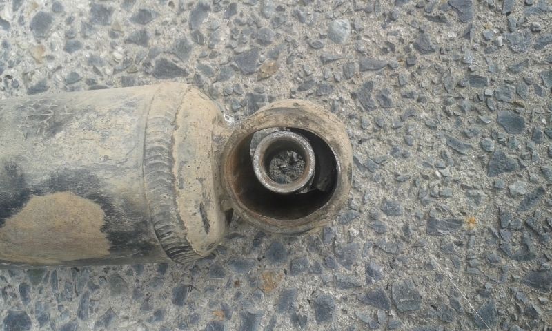

Also replaced my front shocks as the left one was completely shot... Bush what bush?
Much better

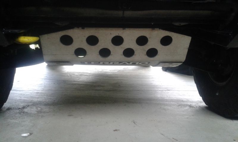

Lastly, I finally got around to fitting this bash plate that had been sitting in my shed for eternity

Post by johnny262 »
How did you mount the rear of your bash plate, fab your own bracket?
stovanovich
Posts: 286
Joined: Thu Oct 17, 2013 5:54 pm
Location: Auckland, NZ
Re: Building Te-Rino
Post by stovanovich »
johnny262 wrote:How did you mount the rear of your bash plate, fab your own bracket?
Just drilled and tapped some holes in the crossmember. Have since swapped back to the factory Bash Plate though as that alloy one is just do big & heavy for so little gain.
