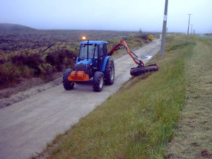

been thinking about this myself a few years back, these are my thoughts
pro on tractor;
;self powered,
;pto to cutter bar easier to link up
;bar possibly easier to operate
;more maneuverable
;possibly tow a trailer to carry tools etc
cons on tractor;
;old cheap machines require high maintenance
;ongoing costs of repair and maintenance
;operator skill issues or lack of operator skills damaging the cutter and/or machine
;storage of machine
;transporting the machine form place of storage to track and back again
;if machine is to be towed, by whom? on what? does the trailer stay with the machine or hired?
second option...
Hydraulic power plant mounted onto a h/d trailer un-braked and towed behind a 4x4
pros for;
;maintenance on trailer a lot simpler
;power plant if conventional diesel a lot simpler to maintain
;bar system can operate on slides for in and out to gauge width and use hydraulics to raise and lower
;easier to store a 8x4 trailer
;easier to transport
;at current moment it will cost around $55-$65 per year for 1 x wof and 12 months rego.
;use old 31 to 33 mud tyres or similar, plenty of them around and will cost nothing as they only get tossed once owners up grade
;less skill required as the driver just drives and a second operator will operate the cutting bar
;extra gear can be easily carried by either the tow vehicle or on the trailer
cons against;
;not as maneuverable as a tractor
;requires tow vehicle pushing through the track before the cutters can do their job
;depending on set up bar height may be come an issue
;initial set up costs will probably be a lot higher than a tractor with pto
i was keen a few years back but with work and life getting in the way and watching top exces bitch and scratch at each other i lost interest
still it is a good idea if something ever eventuated form it, and im keen to lend a hand in some way if possible, if required...
Cheers Rohan
the reason for tractor is
1 cuttiing 7-8 ft gorse in front before going thru
2 ive got spare pto winch wich im happy to put on it for those dificult banks to climb lol
3 i have nothing but tooo much time on my hands lol
4 exaples places like in the kopra it can b kept while work there being done as for west coast if its working im my area it can b parked here .. as for transporting if a trailer is needed im sure there are enough clever buggers to build one
