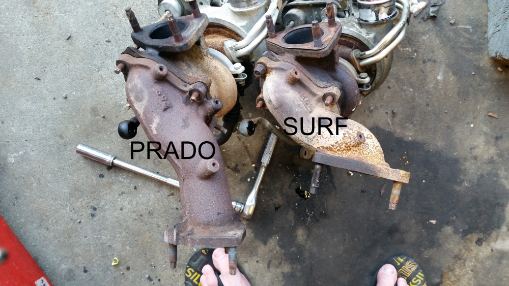

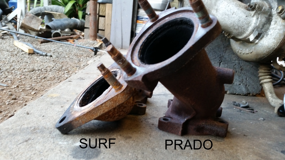

So, another fairly significant difference (I wish I'd noticed before the engine was in because as most of you know how much fun it is to remove the turbo) is the dump pipe.
The 1993 Surf & 1996 Prado dump pipes are completely different. Good thing is, the flange to the turbo is identical so I removed the Surf dump pipe and fitted it to the Prado turbo. Now to put turbo back onto the engine and theoretically the Surf exhaust will bolt up...
