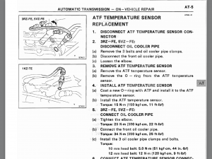

Also looking at the picture you posted...
For the 1KZTE the sensor is in the line via a Tee of sorts.
Where as the Petrol engines ones have it in a port just forward on the side of the box.
Perhaps you could tap into that one...

Under the vehicle I definitely see the T you mention. It looks like the diag above, the sensor screws into one of the cooler lines from above.
I didn't notice that torx bolt in the link you posted. Will have another look as that could be the go if it's there! Thx for that
