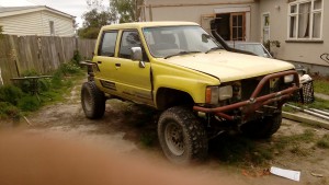

Hi all this will my built thread!
LN65 double cab sitting on standard 31s wellside Bighorn meshes that are terrible in construction and comfort one plastic snorkel and a terrbile front bumper
the engine was a 2.4 from a 91 hilux i was told by the previous owner after a year or so i got sick of looking at the oil bubbling from the radiator an swaped it for a 5L from my pall Ricky at Chaney automotive on an site note him and bill are they guys in the know about VX cruisers an general 4wd etc had heaps of solid advice an knowledge from them and are always keen to help out
along the way there i installed a body lift of 50mm that i got for free from the guy that owns the "tonka" surf butchered the front bar to mount a winch on multiple times untill it worked also made my own flatdeck that was great for a while but after last weekend the 11th of october ive had enough of getting stuck due to mod cons needed in daily road use.
Plans for my truck
Rears up front move the front axle forward 50mm to correct approach angle and allow the tires to clear the footwell(most fabrication ill do myself)
Build a new tube frame bumper and exo to follow
extended shackles will be a must along with springs
mounting the winch under the deck with it coming out the front like the older landys
chopping the chassis down to the back of the spring perches
fabricating the deck to accommodate 4wd accessory's and spare and work in with the exo
ditch those darn recaros for some better bucket seats
axle trussing and Armour ! switching the 4.8 diff heads i have for 4.3lsd units
Rear mounted battery for the winch to draw from
33' tyres or 35' haven't decided
Im looking to build this truck up for trips to the coast around New Zealands beautiful rivers this isnt pure off road
Cheers Ray pics to come

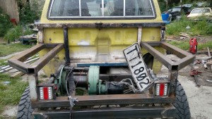

What is the winch?
- Winch master
- Posts: 14
- Joined: Tue Jun 02, 2015 5:46 pm
Re: Hybrids Lux (LN65)
i picked the winch up from a tow truck i know little about it still trying to get a model number etc an work out GPM but im certainly looking forward to it being up an running
- mudlva
- Posts: 2918
Checkerhead wrote:What is the winch?
My guess is that it will he slow but exceptionally strong.
Looking at it. It looks like it drives a sproket simalar in size to the drum diameter.
Tie it well to the chassis as it could well pull the whole tray off otherwise.

yeah ill post up some pics when i pull it down the freespool is sticky
slows okay along its relentless in its pulling power ive bolted it too the chassis
- mudlva
- Posts: 2918
HYBRID1337 wrote:yeah ill post up some pics when i pull it down the freespool is sticky
Get it going and post a vid.
My bet is trees will cower in its pressence

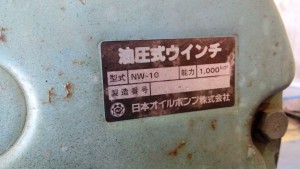

Also your main winch looks more like 2 times 20 to 1. Which would be 400 to 1. Most PTO winchs are high than 20 to 1 (usually 27-32 to 1) and they have a whole engine to drive them.
Thanks for the pics. Does the winch have a brand or model or anything?

The NOP with the gear symbol around it is from the Nippon Oil Pump company...
If thats any help...
