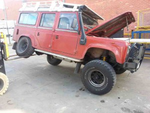

Well i have made choice to come home. been in aussie for 7 years and the laws over here are becoming more and more anti Kiwi, nor is it the lucky country any-more.
But i have been gone for longer than that, living and working in some of the worlds shit holes.
i intend to bring my 85 110 4bd1 with me. its actually quite cheep to do.
but my concerns at the mods and what is acceptable in NZ as opposed to the effectively no rules in SA.
boogie is gone
no sway bar
126ltr fule tank
LPG fumigation
front dislocation cones
TJM original bull-bar,
winch
duel battery's
solar panels and roof rack
lockers
and sitting on 33" 12.5 R15 BFGs. now im up for new rubber, so if i have to slot down to 10.5 ko2s that would not be bad, just can i keep the R15 or do i have to go back to R16?
all help would be appreciated.

Only issue I see is the front dislocation cones . Springs have to be retained or held by mounts at full droop on the hoist .
They might also pull you up on any aftermarket steering components .
and possibly require new brake hoses , pads and rotors .
I would go with factory rims and tyre size ie 235/85/16
also make sure it is really really clean

Hay big thanks.UBZ wrote:Only issue I see is the front dislocation cones . Springs have to be retained or held by mounts at full droop on the hoist .
brake hoses are new and braided, and longer
i can pull out the cones and just drop in the std length shocks up front.
she is 1985, wheels were thin and Bar treads. or could i get away with the modern or latter model wheels and rubber?
any thoughts on the bullbar, i read that it cannot be to far forward, mine is std for the year but there is a lot of air in between

They will put it up on a hoist, have a poke around looking at all WOF related items, bushes, bearings, ball joints, rust, brakes, brake hoses, suspension, lights, wipers, seat belts all the usual stuff.
As UBZ said, they get a bit funny about us L.R folk and our dislocation cones, they don't seem to understand that the point of the cone is to hold the spring captive so it can't fall out. They freak out when the hoist goes up and all four of your springs come loose at one
The other thing you mentioned is the braided brake hoses. Few years back they got funny about those and pretty much band them altogether. They might not like that.
My advice is get it really clean and pretty, especially underneath with half a dozen cans of black paint. Make it look like a really nice truck, as standard as possible because they aren't going to have another stock truck there to compare it to. Make it low key, not screaming lifted modified Defender on 33's!!!! Then take it in for inspection and just do what ever they want.
Can lend you set of stock rims and 750 16's and a set of standard springs if they picky!!

Vehicle will need to go through compliance and also certification for the modifications.85County wrote:Hay big thanks.UBZ wrote:Only issue I see is the front dislocation cones . Springs have to be retained or held by mounts at full droop on the hoist .

Braided brake hoses are OK as long as they are sheathed (have cover over the braided hose) and with proper crimped fittings.
Relocation/dislocation cones are also OK, plenty of vehicles have them and have passed certification.
Regards your basic list, I don't see anything in there that is likely to cause a problem, including current tyre size and bulbar.
Biggest thing is to ensure that it is not rusty, especially in chassis, bulkhead and doors.

well the brake lines are not sheathed, so.
i am not a fan of lift, not needed with what i do, having said that a 85 110 is lower than a puma ( and heaver)
i had already red the " non std shock mounts. so the twin shocks will have to go, that's a given
std shocks will fix the dislocation
will do a blast though the Simpson next year when the place opens again, that's good for a sand blasting job underneath, then hit it with the black cans.
question, i have removed the rear sway bar. is this an issue?

Non standard suspension parts are OK, they just need to be certified, along with the twin shock mounts.85County wrote:well the brake lines are not sheathed, so.
There are vehicles here that have been certified for road use that use long travel plus 5 inch shocks, revised shock mounts, twin shocks.
Even wheel spacers are legal if certified, generally they need to be hub centric though.
If brake hoses are unsheathed then its only a small cost to get replacements that comply. Either from suppliers or they can be custom made here for around $120 each (last time I priced some up).
Regards sway bar, given age of vehicle, sway bars were probably optional back then so as long as it drives, handles OK, then it will pass with out it. I took mine off and have had no problems with 50mm lift springs and shocks.

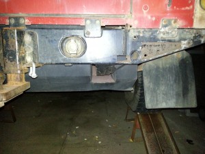

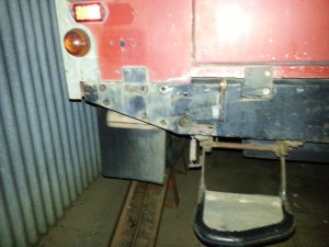

reading the above advice, i decided to make the chassis look like new, bling bling. so a few cans of wattle rust kill in black, cans of degreaser and a water blaster.
4 car ramps makes it not so hard on the elbows.
1st clean ended up with 6 buckets of crap on the drive way, second clean only the 1. my eyes are full of crap but at lest the wet concrete is not to hot to lay on.
Now for the last few year i have been quite proud that MY "COUNTY" is rust fee. pride before the fall. that one little paint blister on the rear cross member has turned into this
not to hard a job, 150x50x2 galv and a bit of 2mm flat bar. the silly thing is i got a Length of RHS a few years ago and made up 3 sets. and gave/swapped them away, GGGRRR
in years gone by i would cut polish etc and she looked quite nice, but that's close to a decade ago and i was running out of paint ( to thin), plus the sun is quite hard over here.
most cars at around 10 years have no clear coat on the roof or bonnet.
Re: WOF
ok after a few days of mulling things over and getting prices.
a galv replacement from pommyland about 2K by the time i get it here.
second hand chassis and get that galvanised, again about 21/2K but a hell of a lot of work
so i have got the local sheet metal shop to cut out some cold roll for me, just the ends, i will fold and box in myself, make it a closed box and fill it with fish oil should do the trick.
