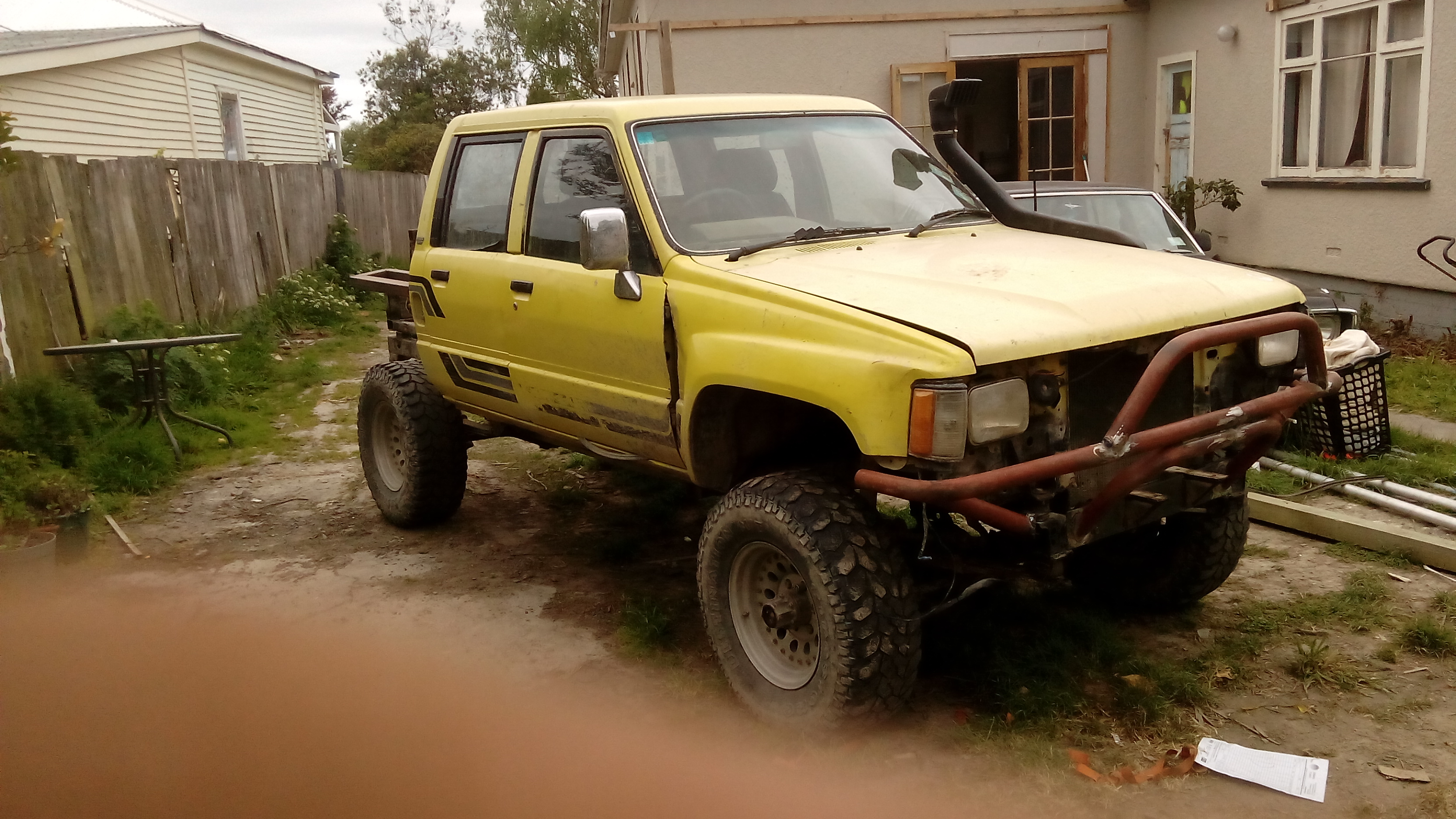

just a few pics from labour day weekend

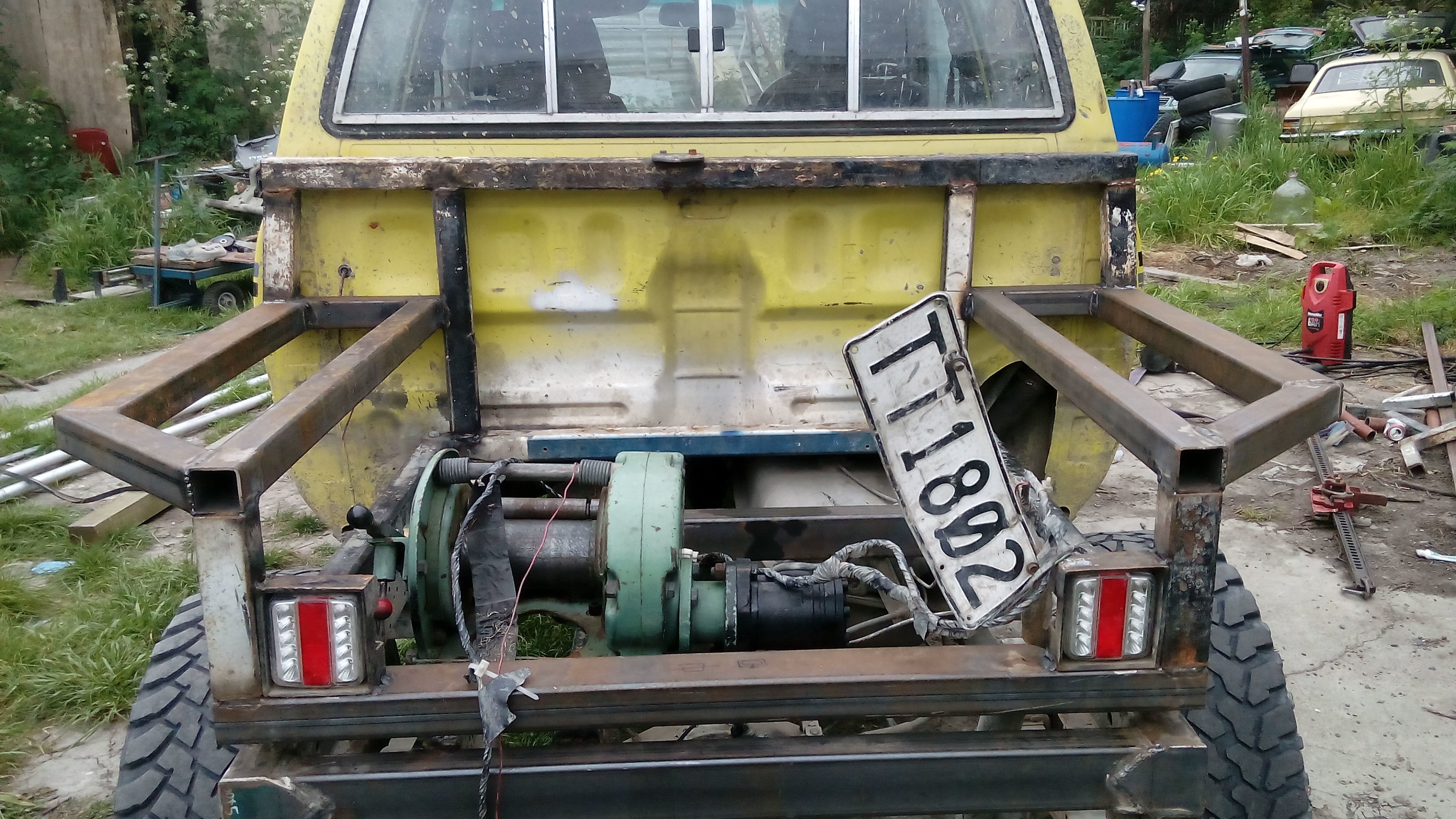

What is the winch?

i picked the winch up from a tow truck i know little about it still trying to get a model number etc an work out GPM but im certainly looking forward to it being up an running :D

My guess is that it will he slow but exceptionally strong.
Looking at it. It looks like it drives a sproket simalar in size to the drum diameter.
Tie it well to the chassis as it could well pull the whole tray off otherwise.

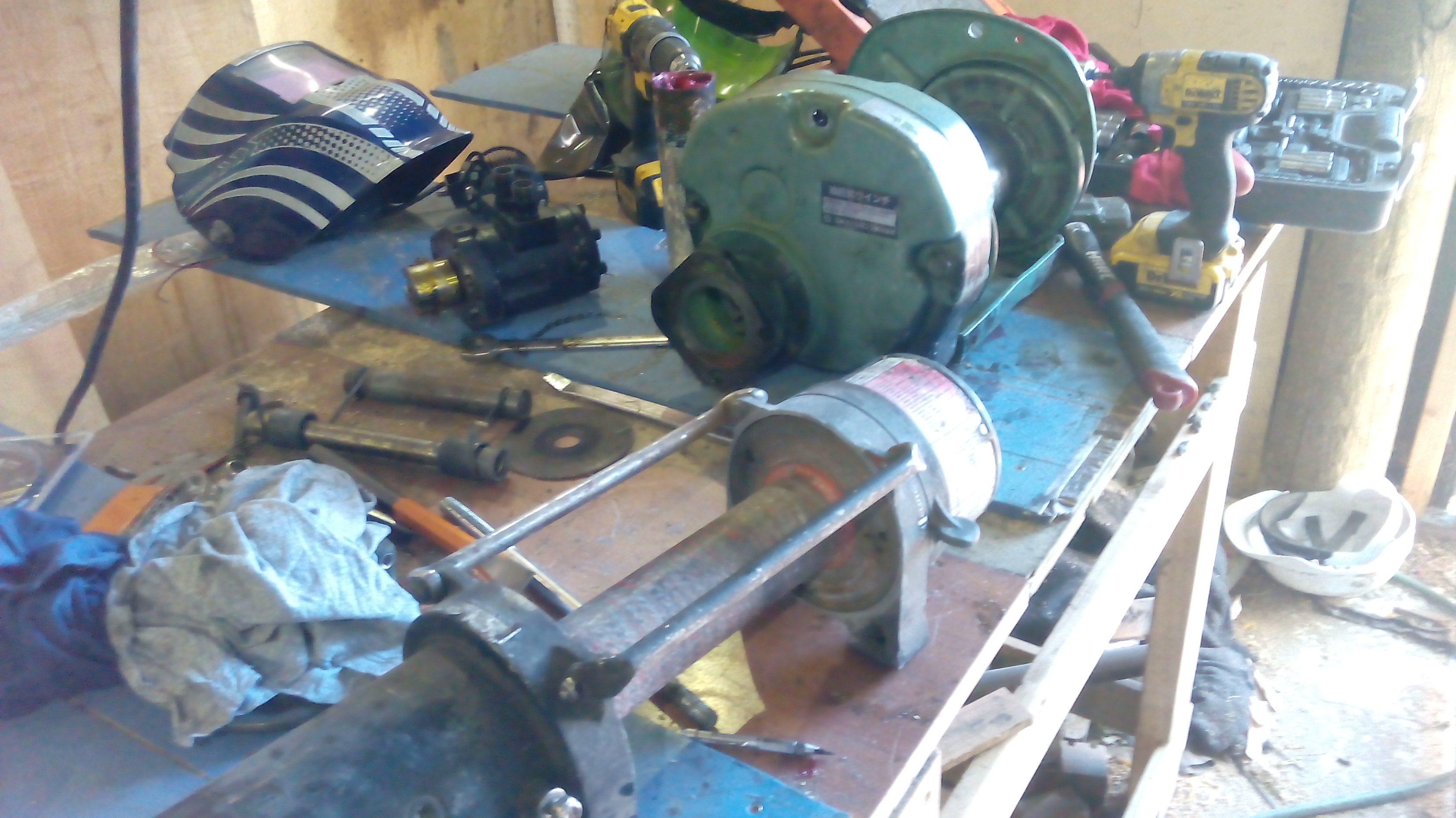

yeah ill post up some pics when i pull it down the freespool is sticky
slows okay along its relentless in its pulling power ive bolted it too the chassis

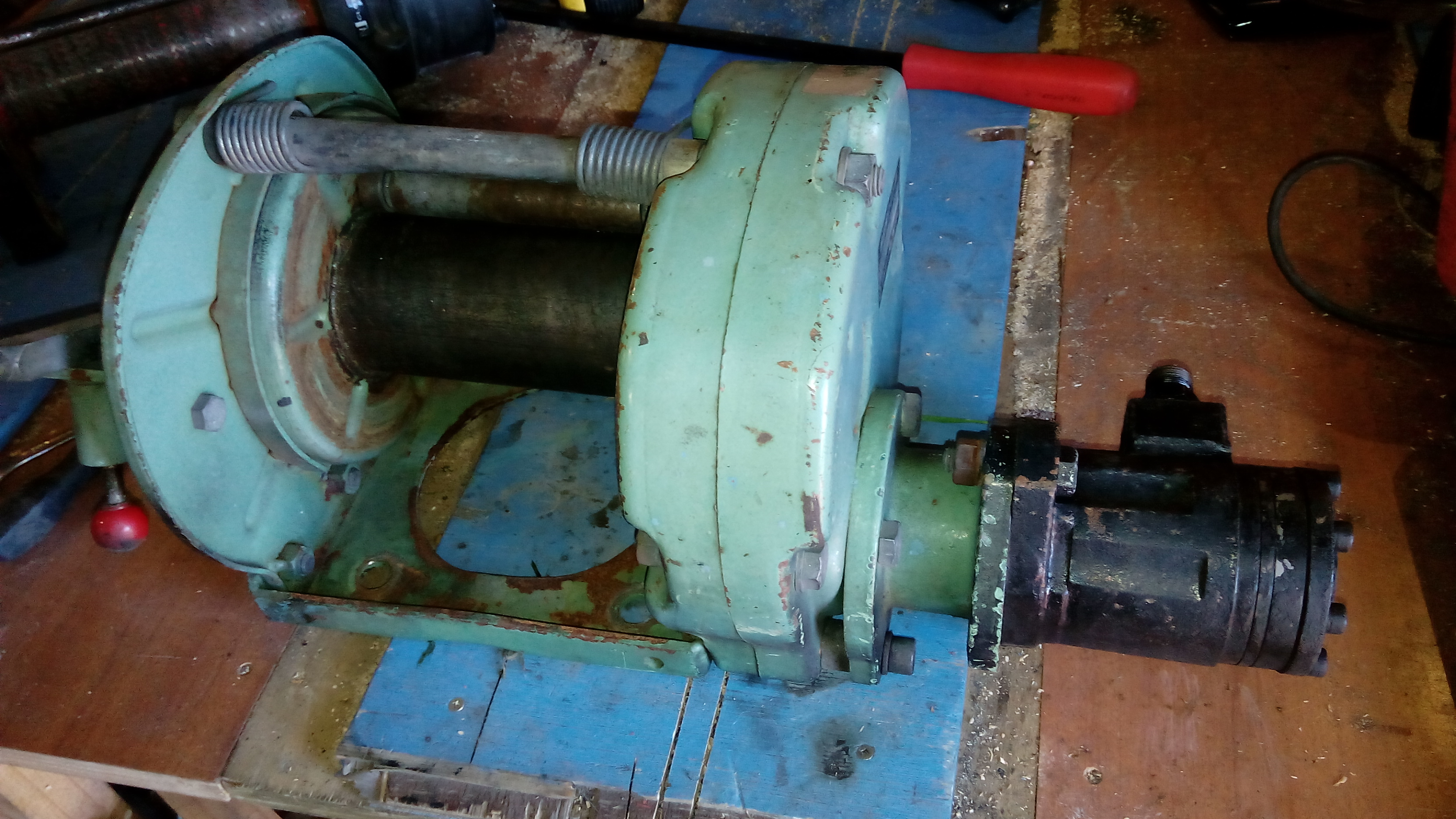

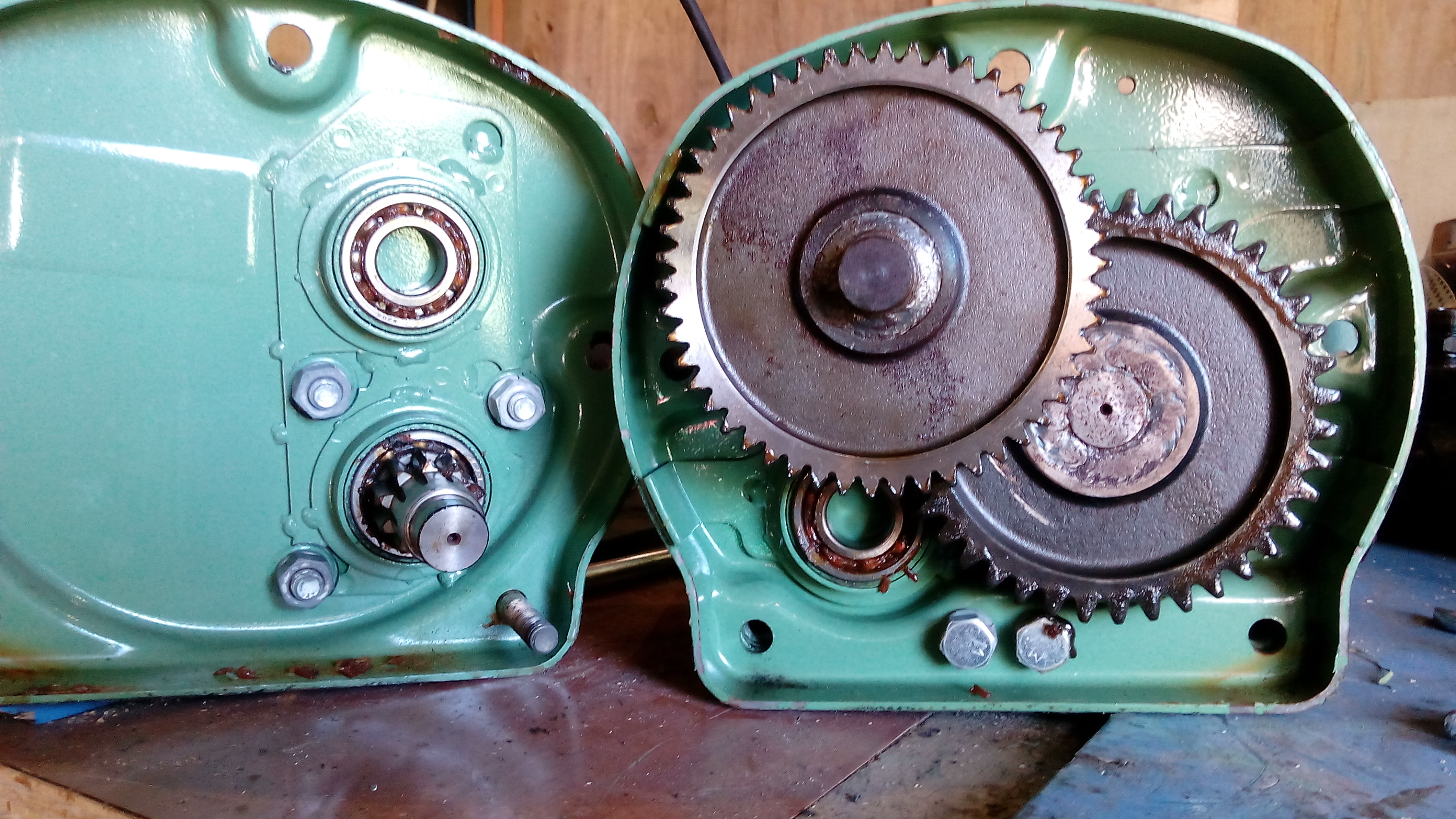

i striped down the winch this morning its beautifully simple in design has a 20 to 1 ratio
also i gave my other $15 eco shop winch a quick grease

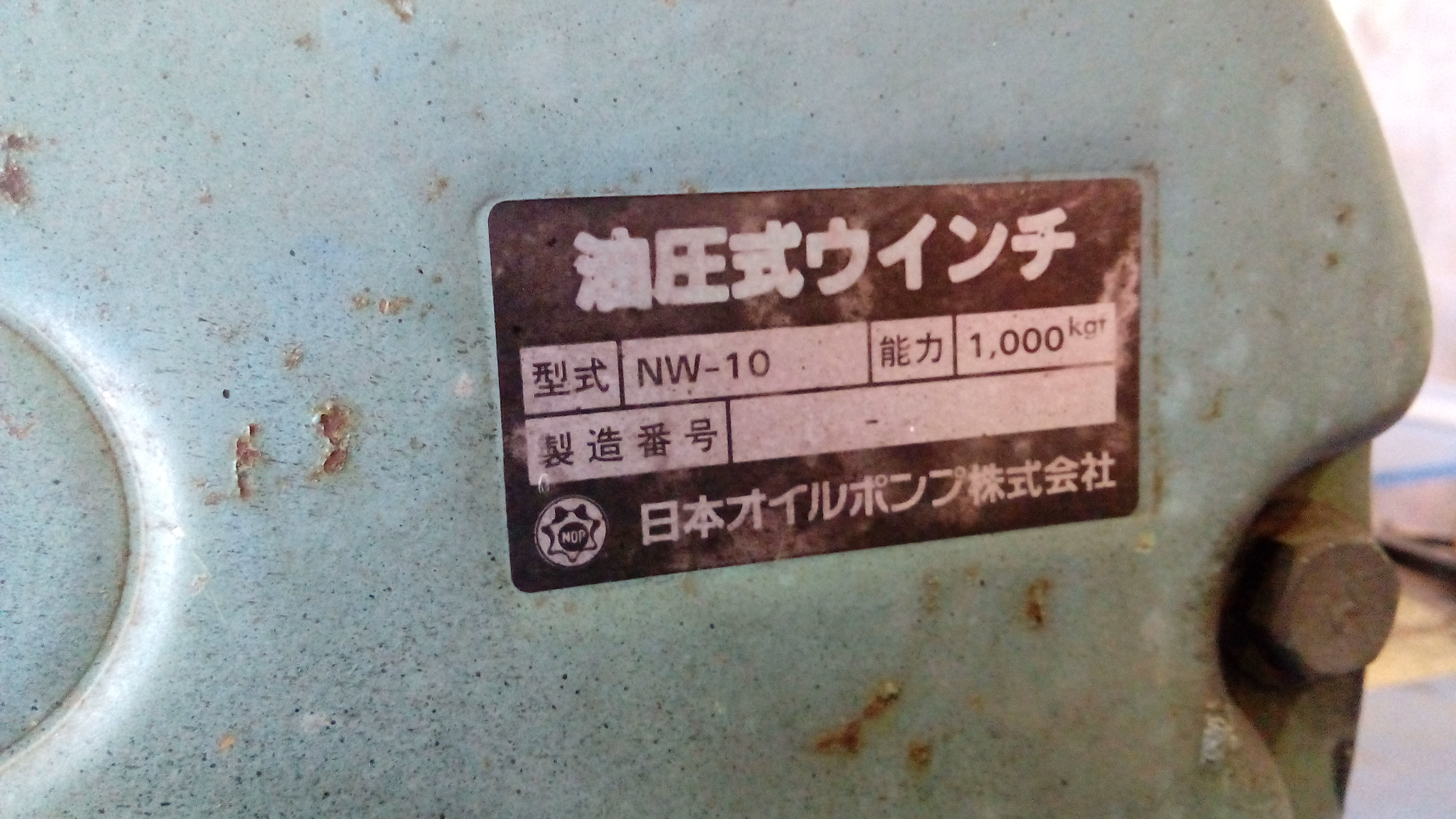

Also your main winch looks more like 2 times 20 to 1. Which would be 400 to 1. Most PTO winchs are high than 20 to 1 (usually 27-32 to 1) and they have a whole engine to drive them.
Thanks for the pics. Does the winch have a brand or model or anything?

yea it was 20 input rotations to 1 drum rotation i was meaning
i cant translate it unfortunately

The NOP with the gear symbol around it is from the Nippon Oil Pump company...
If thats any help...
