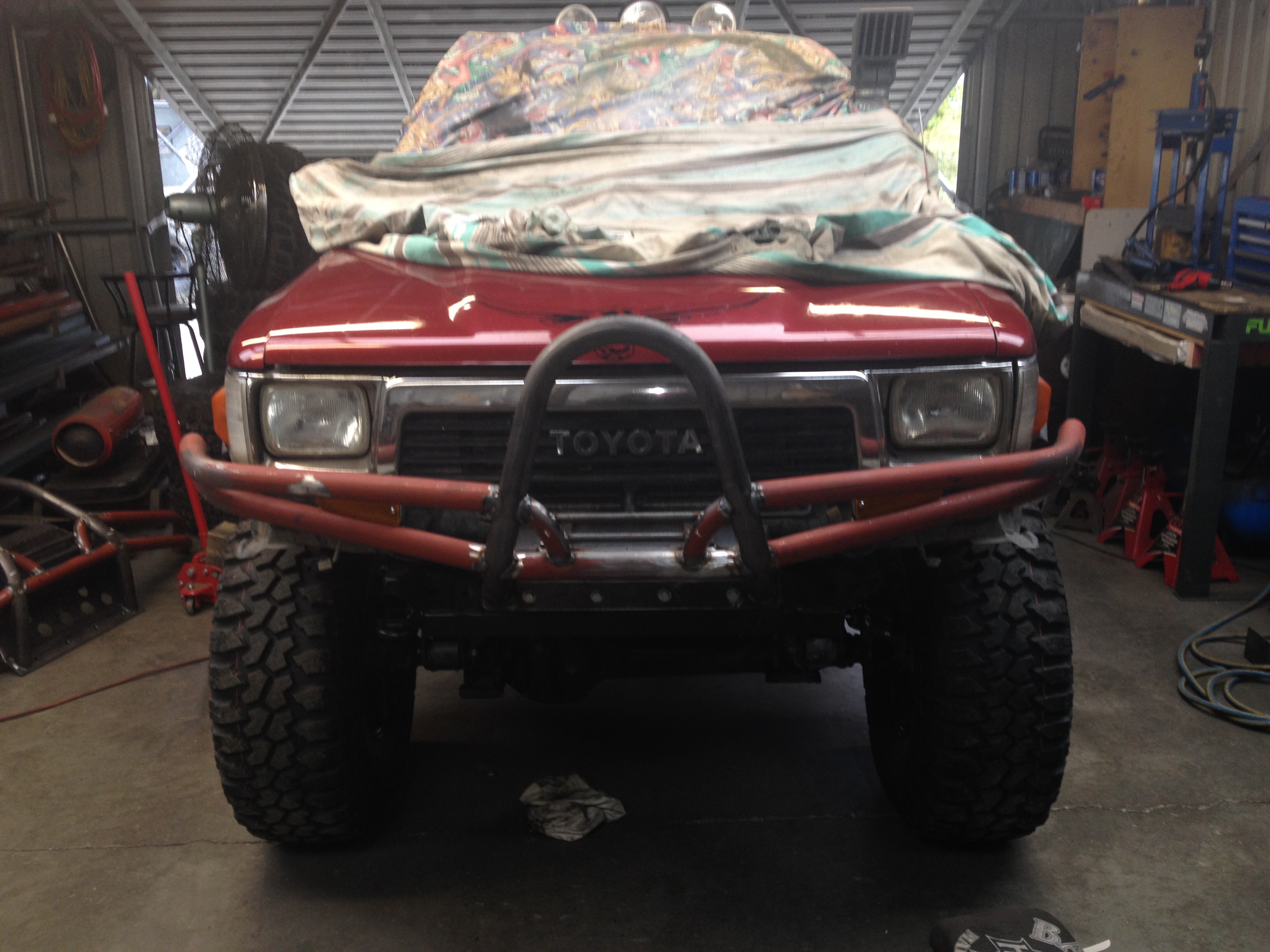

Getting though it bit more done with all hands on deck
Spring mounts panard done hydro bumps mount in
Had to re make radiator pipes and a new line
Rear bump stops done
Water proofing and tiding up electrics
Notched sump for top arm
Bullhorns done as struggled to loop the rope round last time
Mounting rear winch may help for Costa
