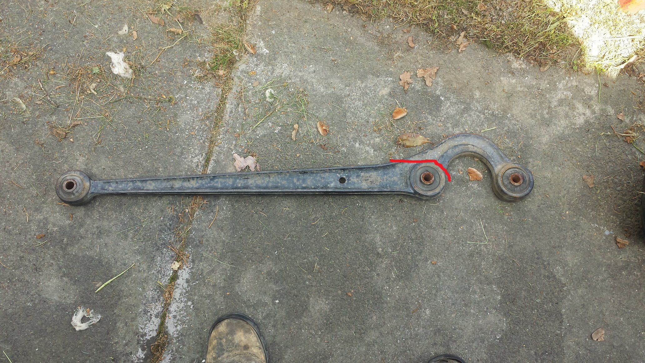

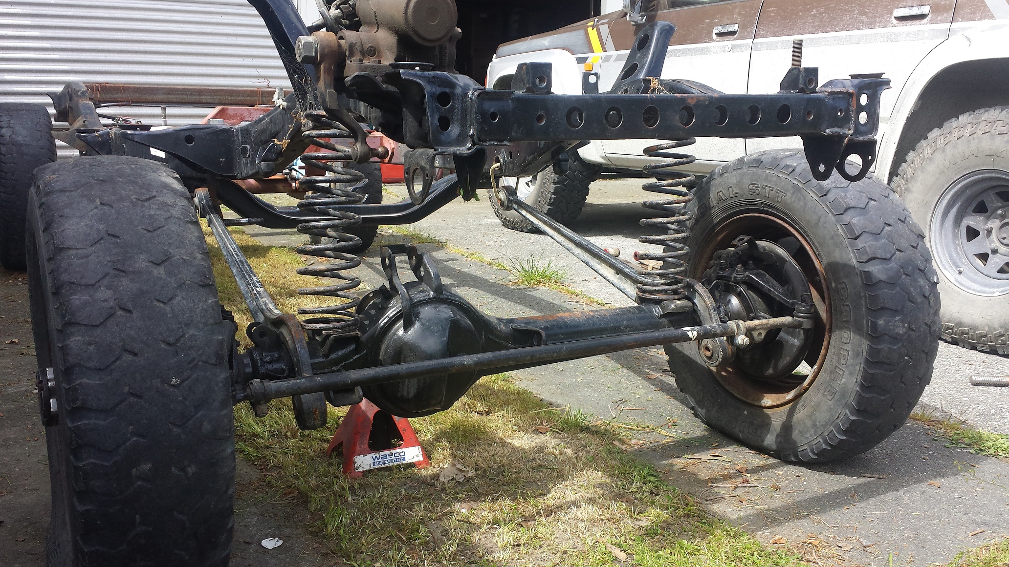

hey all iv finally got my arse into gear and started working on my suspension mod for my ln107 hilux.
iv got some radius arms and iv mocked them up onto my dummy chassis, looks like itl work but i am really wanting to make a 3 link to get the most from it but being a family man i cant really spend tons of money on it so am trying to make do with what i have even if it means not having a 3 link.
heres what it looks like so far...
has anyone cut radius arms like this to use as 3 link arms? does anyone know if its legal? we dont seem to have a cert man in town so i cant just duck down and ask him. it would make life easy and alot cheaper this way. iv already made my top link, its at work so cant get pics right now. cheers

with the rubber mounts and the limited seperation on the link with the double mount you will get enough movement to make this rather scary at road speed, so I would say not a chance of making it road legal as a certifier has to pass this on its road handling
Can't really see it from the photos but you may have a caster issue (the diff head looks like it has been pointed up a bit...) this will remove caster from the steering meaning on the road the steering won't self center and will wander
What size tyre are you planing on running, looking at the lift I'm guessing 35"s.... for nice road manners you want to drop the drive flange of the diff to increase the caster (you want it at 3-4 degrees for the bigger tyres)
An option to keep drive shaft angle and improve caster is to grind out (or machine) the welds that hold the swivel housing balls in place and rotate them and reweld.... run a search on here for a hilux build for "Jafa" a very good thread you'll learn a bit

The other way to get the caster angle right is to lower the height of the axle stand under the diff pinion
theres no need to chop up perfectly good radius arms its piss easy make the links out of a length of tube mate then you get them all at the correct length to work for your application

Pretty Sure Madaz has chopped radius arms in the rear of his (very successful and road legal) Surf winch truck. Set up as a 5 link though.

My castor angle is just like that due to the axle stand stopping it from flipping up. It will be adjustable if I get my way so its not an issue yet.
Re: can i do this with my hilux SAS?
And It will have a panhard aswell if youre wondering.

Yes it is easy to make some but since iv got arms with bushes etc already it saves me buying rod ends therefore saving money for other bits. Shouldn't it work just the same anyway? Just might need bushes more often depending how hard I use it offroadderk wrote:The other way to get the caster angle right is to lower the height of the axle stand under the diff piniontheres no need to chop up perfectly good radius arms its piss easy make the links out of a length of tube mate then you get them all at the correct length to work for your application

I don't know how you are planing on doing that with radius arms.... additional mount holes won't work as they will have to rotate the housing that much it wouldn't be usable and slots won't pass cert
Your pan hard bar won't do anything to stop the forward and back rotation caused by the rubber mounts on the radius arms (by the way its a requirement to run a non triangulated link setup)
Why do you need 3 link ? the radius arm suspension will give you between 10 and 12" of shock travel/articulation and being road running they will also give you some anti dive to stop the nose diving under brakes (you wont get this as easily with links) as for the articulation that is similar to what I used to get with a RUF setup and was good for 1.2m of articulation
Checkerhead don't know much about his truck (hoping to get the chance to drop in and see him while I'm up here) but first if its the rear some rotation of the axle isn't going to effect the steering... and knowing his experience I'd say there is a bit of separation between the bush mounts so this will minimize things oh and it will have 3 bushes attatching it either side lol
Derk my comment about the caster is based on two things the hilux diff runs around 1.5 degrees standard to get the caster to 4 degrees (LVVTA suggest more) he has to drop the diff around 3 degrees with what looks like his lift this could cause some issues with the angle on the front drive shaft (remember his engine and drive train have an angle opposite to the front shaft drop).... but yes that is where he should look first, personally I'd say loose some lift lol but I like sidelings and a high CoG is something I hate

i think were a bit confused about what im trying to do and what youre trying to explain. my original plan was just to use the radius arms as they would normally be but then everyone i spoke to said make a 3 link so i got the idea of making a 3 link and by completely cutting of the radius arms 2nd mounting hole. im basically trying to make honey out of dog shit but these things need to be done sometimes haha. i had a read of that jafa hilux build that this is damn impressive.De-Ranged wrote:I don't know how you are planing on doing that with radius arms.... additional mount holes won't work as they will have to rotate the housing that much it wouldn't be usable and slots won't pass cert

now back to what i was saying, using the cut radius arm as my lower link, and an adjustable arm going from the top of the pumpkin on the diff should make it easy to get my castor angle correct. what are you meaning by forward and back rotation??
my ride height is yet to be finalised im just trying to nut out how im going to attach the diff.
im learning as i go with this so i do really appreciate any advice and do's and donts you have.
at the end of the day im hoping to make my suspension as good as it can be on the budget i have, iv got some pretty ngarly places to explore once this is complete.

If you were to use 3 arms cut as links the only reason you could have issue is if the mounts are too close together but if you were to put the top mount on the diff with say 3 holes (options for caster make the middle one 4degrees) and some seperation at the chassis it should pass
