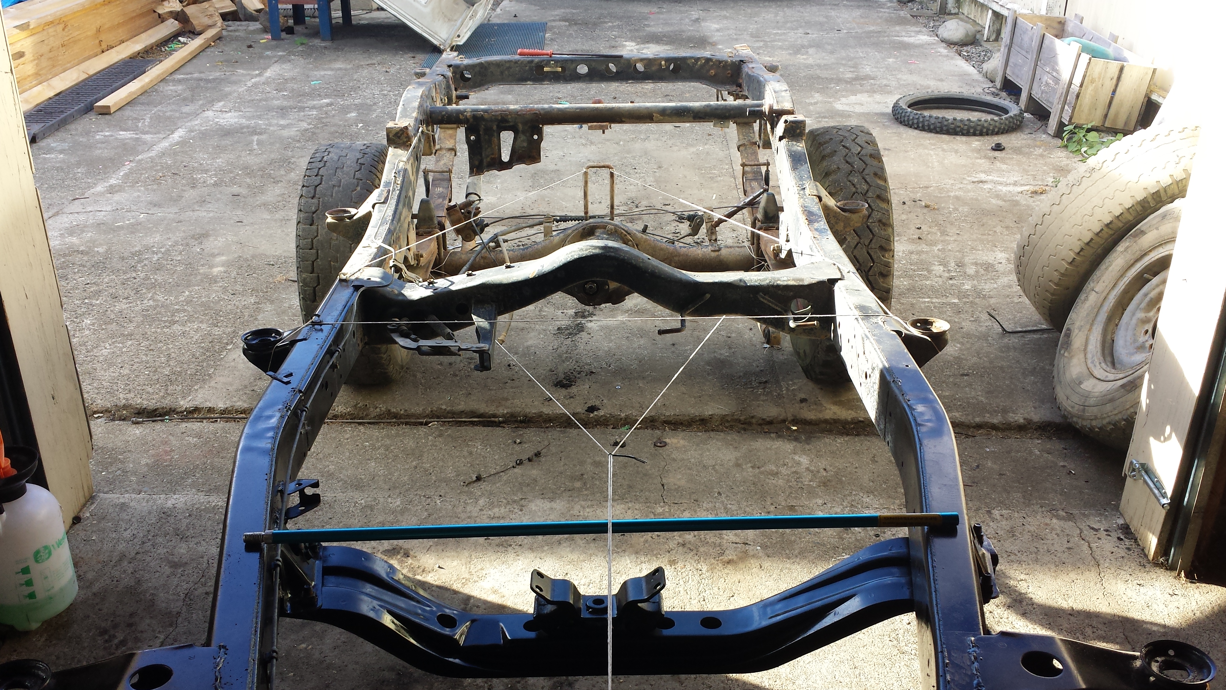

hey all iv finally got my arse into gear and started working on my suspension mod for my ln107 hilux.
iv got some radius arms and iv mocked them up onto my dummy chassis, looks like itl work but i am really wanting to make a 3 link to get the most from it but being a family man i cant really spend tons of money on it so am trying to make do with what i have even if it means not having a 3 link.
heres what it looks like so far...
has anyone cut radius arms like this to use as 3 link arms? does anyone know if its legal? we dont seem to have a cert man in town so i cant just duck down and ask him. it would make life easy and alot cheaper this way. iv already made my top link, its at work so cant get pics right now.

with the rubber mounts and the limited seperation on the link with the double mount you will get enough movement to make this rather scary at road speed, so I would say not a chance of making it road legal as a certifier has to pass this on its road handling
Can't really see it from the photos but you may have a caster issue (the diff head looks like it has been pointed up a bit...) this will remove caster from the steering meaning on the road the steering won't self center and will wander
What size tyre are you planing on running, looking at the lift I'm guessing 35"s.... for nice road manners you want to drop the drive flange of the diff to increase the caster (you want it at 3-4 degrees for the bigger tyres)
An option to keep drive shaft angle and improve caster is to grind out (or machine) the welds that hold the swivel housing balls in place and rotate them and reweld.... run a search on here for a hilux build for "Jafa" a very good thread you'll learn a bit
If you have any other questions PM me

The other way to get the caster angle right is to lower the height of the axle stand under the diff pinion :D theres no need to chop up perfectly good radius arms its piss easy make the links out of a length of tube mate then you get them all at the correct length to work for your application

Pretty Sure Madaz has chopped radius arms in the rear of his (very successful and road legal) Surf winch truck. Set up as a 5 link though.

My castor angle is just like that due to the axle stand stopping it from flipping up. It will be adjustable if I get my way so its not an issue yet.

And It will have a panhard aswell if youre wondering.

I don't know how you are planing on doing that with radius arms.... additional mount holes won't work as they will have to rotate the housing that much it wouldn't be usable and slots won't pass cert
Your pan hard bar won't do anything to stop the forward and back rotation caused by the rubber mounts on the radius arms (by the way its a requirement to run a non triangulated link setup)
Why do you need 3 link ? the radius arm suspension will give you between 10 and 12" of shock travel/articulation and being road running they will also give you some anti dive to stop the nose diving under brakes (you wont get this as easily with links) as for the articulation that is similar to what I used to get with a RUF setup and was good for 1.2m of articulation
Checkerhead don't know much about his truck (hoping to get the chance to drop in and see him while I'm up here) but first if its the rear some rotation of the axle isn't going to effect the steering... and knowing his experience I'd say there is a bit of separation between the bush mounts so this will minimize things oh and it will have 3 bushes attatching it either side lol
Derk my comment about the caster is based on two things the hilux diff runs around 1.5 degrees standard to get the caster to 4 degrees (LVVTA suggest more) he has to drop the diff around 3 degrees with what looks like his lift this could cause some issues with the angle on the front drive shaft (remember his engine and drive train have an angle opposite to the front shaft drop).... but yes that is where he should look first, personally I'd say loose some lift lol but I like sidelings and a high CoG is something I hate

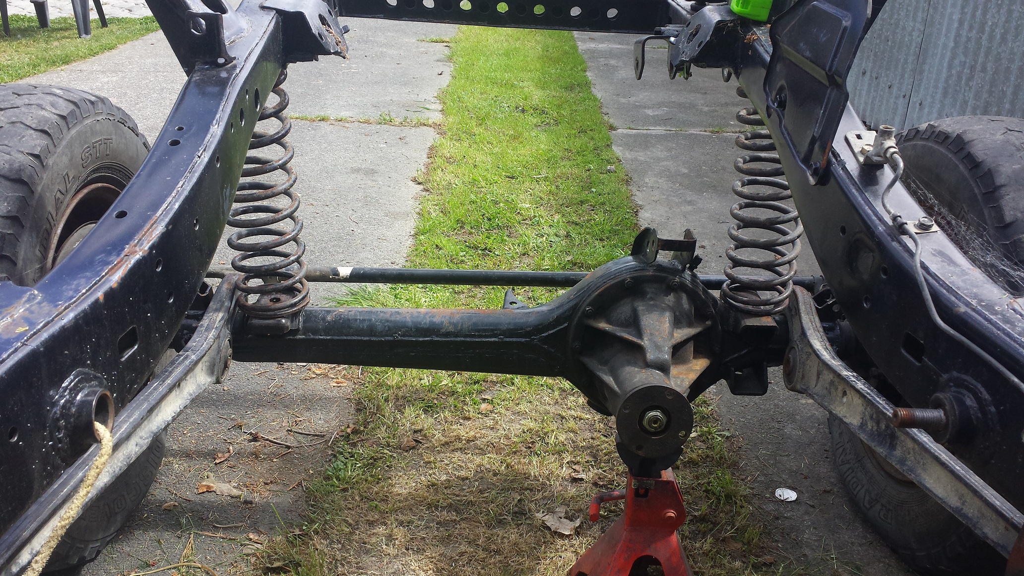

Lax you are right that bounce has more to do with the wheel base than the angle of the links or AS with out turning this thread into a debate over how AS causes this and how much AS is a good or a bad thing (been discussed before and from memory me a Rok have slight difference of opinion on the levels that cause it)
Now the biggest factor and it doesn't cause it is the WB but it has more impact on this than anything else, you understand the Center of Gravity, imagine a triangle top point is CoG bottom two points are the wheel contact patches... now point the truck up a steep bank, your triangle tips back.... with a short WB the triangle is closer to tipping than a longer WB this makes the shorty more susceptible to this
Hey Mud can you remember your Roll Axis Number with a road going truck this is the most important one as it is how it steers and handles (understeers or oversteers) with out going into it too much with the rear you want it as close to 0.0 as you can get
AS and Roll center height are personal and depend on how you drive

100% agree with everything there Reece. I think the bit we differed on was how much AS was a good thing. But as you state, that is personal preference and comes down to how you like things to behave when driving. :D

i set it up something like this....
im currently re making that crossmember but you get the idea. does it look about right?
