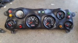

This is mine it would pass wof if required
Try capital civic in ak or cc unsure about wellywood tho

Looks good mate, and thanks for the site. They have everything I'm looking for

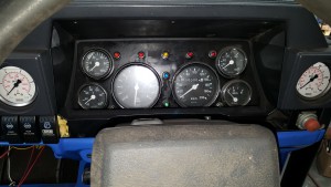

The speedo ive got has a odometer. The photo was a bit dark but if you zoom in on it its there

I see it now. Is it posssible to adjust them? As in set them to the current km's of the car?mudlva wrote:The speedo ive got has a odometer. The photo was a bit dark but if you zoom in on it its there
